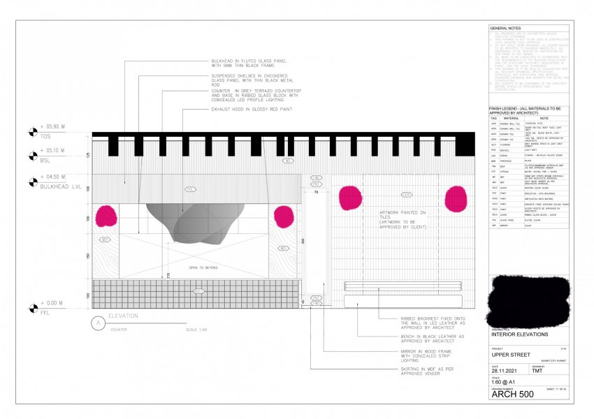

The restaurant's build is almost complete, with interior finishings currently being applied. I've attached images of the floor plan and sections of the space with coloured markings for the whereabouts of the D.J. booth and speaker placement proposal for anyone interested in size and layout (yellow: booth, pink: speakers). A key with materials used is also included - there isn't much leeway to apply acoustic treatment. Maybe pyramid foam within the waffle spacing of the concrete ceiling. I also feel like the large floor to ceiling windows and wall tiles would create a lot of reflections, especially with how I'm planning to orient the speakers. I have suggested adding thick drapes to help remedy this for the owners, and there would be a few carpet art pieces hung that help in absorption as well.

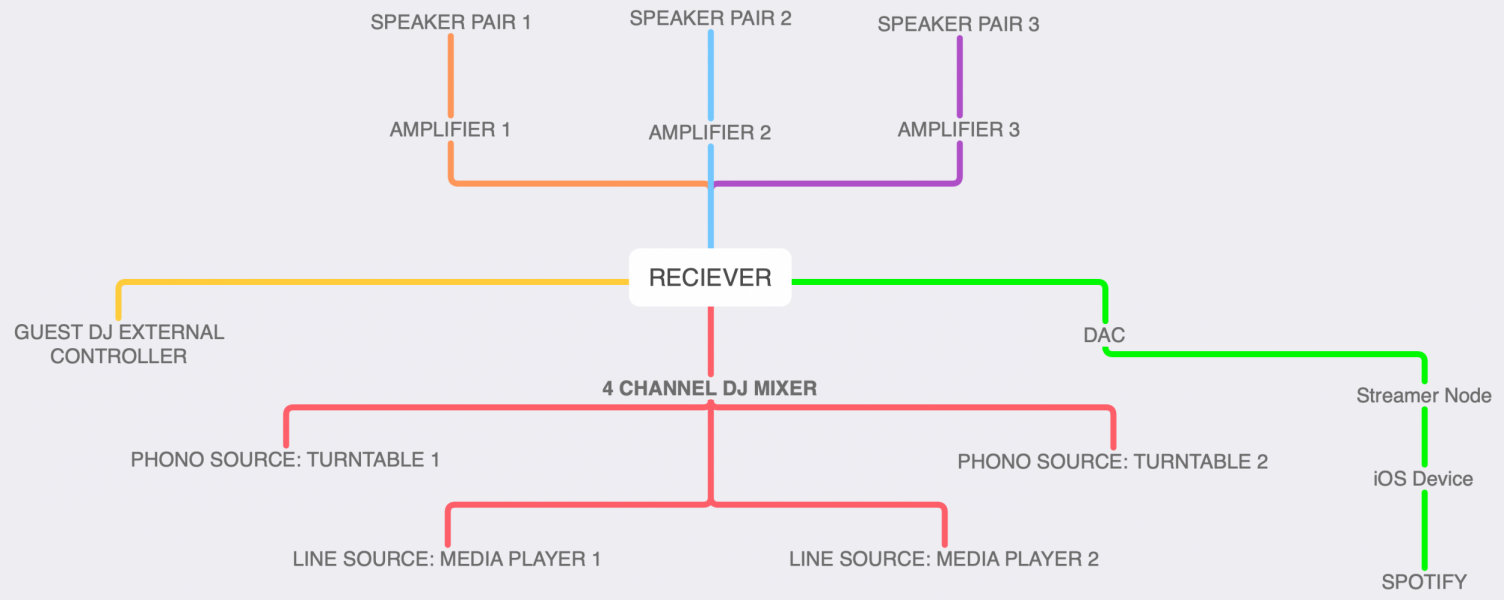

There are a few missing puzzle pieces in the system due to my lack of experience, and I was hoping that anyone could kindly assist me. Looking for a receiver that will take the 3 different sources (in-house D.J. mixer output, DAC-Streamer Spotify output & guest D.J.'s controller output) and send the output signal to all the amplifiers powering the speakers. Would home theatre A.V. receivers work? I've checked the backplate of most A.V. receiver products, and they all have 'surround', 'front', 'center' labels for the different speaker outputs. I'm worried about whether each pair of speakers would get other signals - which wouldn't work in my application.
I've also done my best to map out how the sound system component network would work with a resident D.J. system in a booth, guest D.J. with an external mixer, and DAC for regular musical playlist programming when there's no D.J. performing.

- 2-3x pairs of Klipsch Hersey IVs - suspended or mounted on walls/columns upside down with a tilt angle. The horns would point downwards at the customers and the woofer closer to the ceiling to create a similar low-end response when placed ordinarily in a floor-standing position. The speakers will either be suspended by eye bolts and fender washers hung from a concrete beam waffle structure or mounted on french cleats on the structure's columns. They will be powered by:

- 3-4x Klipsch RP-600M II - also considering fitting them upside down with a tilt angle. The horns point downwards at the customers and the woofer closer to the ceiling to create a similar low-end response when placed ordinarily in a floor-standing position. But the 600 IIs would be mounted on the walls/columns versus being suspended from the ceiling.
