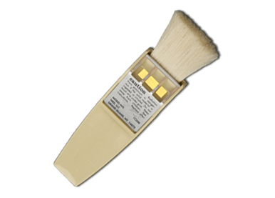

It is an old phenomenon, and the reason why the leader used between the songs on master tape is made of paper, that does not generate static charge.

So can I use my record brush?
You can try it. The brush I suggested is tried and true in industrial and laboratory environments. I used these in the darkroom for years.
An anti static ion gun could also work.
The brush wont damage the tape if if gets close?
No. It’s not magnetic. It’s ion based. The polonium cartridge gets replaced every year.
It seems like an expensive solution, but no one has suggested that tape is an inexpensive format.
If you’re worried, unwind a couple of feet and brush from the far end toward the tape.
You could wrap the leader around a grounded copper bar. No matter what you do, it’s going to eventually regain its charge.
