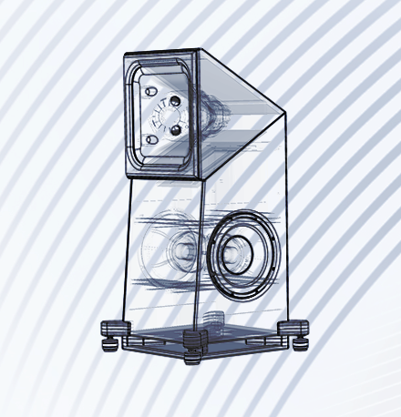

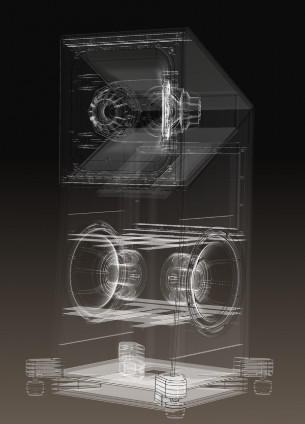

Hyperion-image.png157946442_2053259621483098_3314773651993780328_o.pngHyperion-FR-wt.png

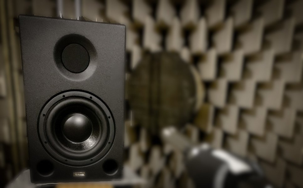

I changed my Avantgarde Trio to a pair of Danley SH50 and was using dozen of different Danley speakers at home and for PA as well. I have a Go2 8 CX and an active Studio 2 at the moment. Studio 2 is a similar idea as the Hyperion. A coax 2-way Studio 1 ( Hyperion is a 3 way SM60F) plus a 10 inch DSP crossed sub (the Hyperion has a dual 15-inch sub). So the Hyperion is the cost no object version of Studio 2 (at least s I see it, I am not sure Danley would agree in my description).
You can see my Studio 2 in the photo below while we were measuring it in late January when I got it. It is very difficult to imagine how the Hyperion can be better than Studio 2 as it is just perfect for my taste and system and room.

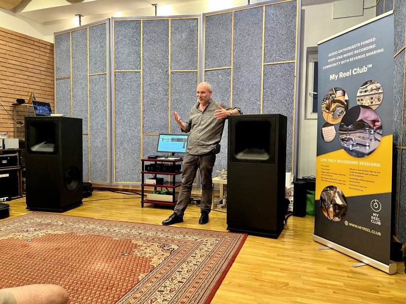

Using the Danley Hyperion (now called HRE) active speaker prototype for our Gabor Juhasz Trio: Planets live studio-recorded DXD/DSD jazz album presentation last weekend in Budapest. In the same studio where it was recorded. We could compare different versions of the recording to the live music too, but we presented a few tracks from R2R tape and a version mixed and mastered for streaming.
It was really exciting as the Danley HREs provided exactly the same volume as it was while we were recording the music (we measured it then). The D/As were Merging Anubis and Rockna Wavedream Signature.
More Danley HRE demos will be organized in the next few weeks in Budapest if any of you are interested.
