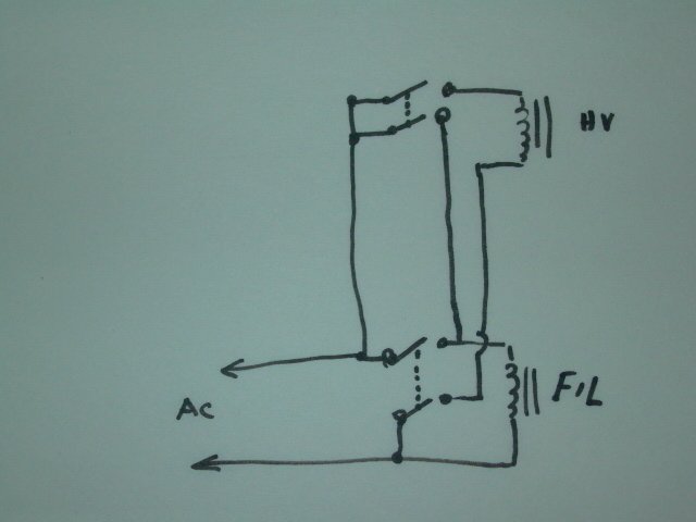

Hi Myles
The original design in use of direct heating tube to replace with a in- direct one should have no problem, but I don't think they care of this matter from the beginning, most of brand name design to put a time delay mute only on the sound out-put for no noise before heating up, we diyer always care of life time of expensive NOS tubes, so I like separate into HV and LV supply, there are a tweak to wire with two switches , you turn on one first no matter which one must be the LV power, till both on for HV power, see picture, up grade power supply (add more supply like one for each tube in amp ) always will have a big positive return

OK I understand Tony :) Makes sense :)
