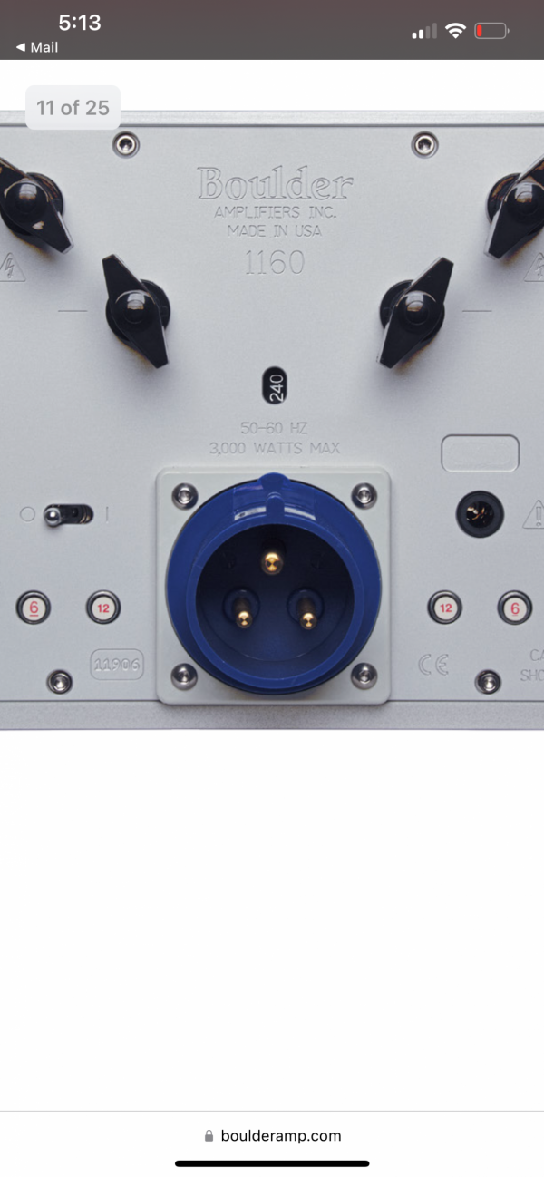

There are 4 breaker switches if it detects a dc line issue. It’ll protect the components from damage.
with the unit off, press all 4 of those little circular buttons flanking the power supply inlet.

I assume those are the ones numbered 6, 12, 12, 6? Press in any order? "Unit off" means with the unit attached to the mains but with the rear panel switch at OFF? Thanks again.

If the unit was tripped by a dc surge, then those kill switches, one of them might be popped out. So while unit it powered down, press all 4 of those switches in so they are flush.
then unplug all inputs, and then power on and see.

Thanks for this - the manual does indeed refer to the DC offset detection (but I'm not a tech guy).. And it also says reset the breakers on the rear panel. But it doesn't say what the breakers look like - Joey above says they are the 4 circular buttons, two on each side of the mains power input.
So perhaps I should disconnect the pre-amp and see if that does it; and after that try pushing the breaker reset buttons.
