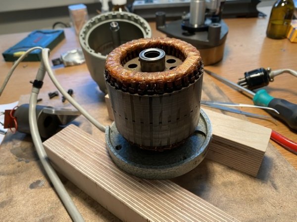

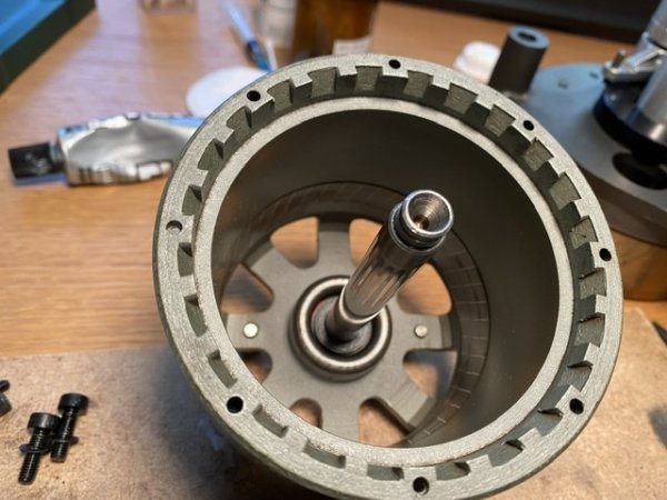

I disassebled motor. Sintered bearings is perfect, runing smooth and noiseless. I oiled with Mobile DTE light oil, as recommended. Noise is little bit less. But on lower speed still big nise and vibration.

I m just a mechanical guy.:rolleyes:
May be something is wrong with the copperwindings .
And they need to be measured .
Better to ship as recommended .
Online problem solving only goes so far .

Windings is ok. I checked resistance. Good idea have to measure inductance!
Just thinking maybe some winding is shorting. Can not detect with resistance measurement. But with inductance measurement probably can.
