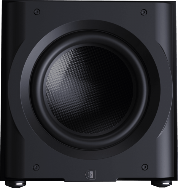

Hi everybody.
This is first time i consider seriously to add a sub to my beloved Tad CR1.
Perlisten subs are really interesting.
First, some info of D212s. The one i find best match for a 25m2 room.

I listened to it for about an hour at Ultimate audio Lisbon , integrated with Rockport Lyras
I requested many different kinds of music , orchestral / organ ,and i couldn t really fault it .
If you dont hear it , but you do hear the extension then its a fine sub (off course the shop set it up right in this case )

I see claims on the company page for this sub model as having "minute distortion levels" but I see no distortion information about the built-in amplifier or sub itself listed anywhere. I could be blind and just missed it though?
For the asking price of this unit I would certainly want to know a bit more about the subs objective measured performance before making a decision on a possible purchase.
In case you are unaware, there are many "Known Good" Subs available for a fraction of the asking price of this unit. But, if you like the Perlisten nonetheless, I guess my only other advice would be to consider getting 2 x Single 12" driver units instead of a Double 12" driver unit all inside the same box. Reason being, you have more tuning flexibility with two separate boxes than you do with only one Sub. Maybe space is a concern though?
It appears you would need a 20A circuit to run the D212 while the Single 12" D12 can run on a regular 15A circuit.
