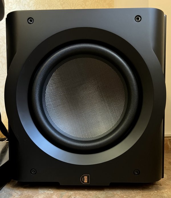

Hi everybody.
No time to write extended explanation.

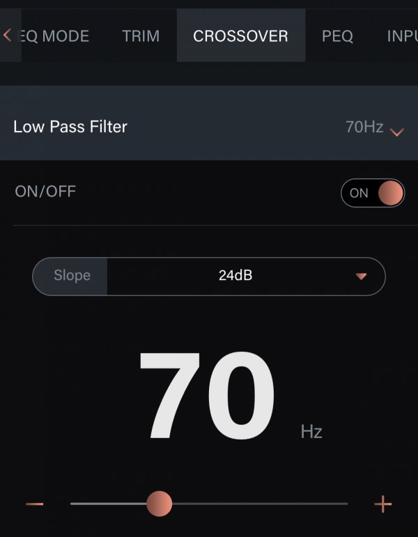

News are i’ve bought Perlisten D12S sub and Esprit cables to do justice with such stunning sub.
No need to do measurements. iOS app is amazing to search right setup and change it when poor recordings or over produced ones makes bass thin or big.
Sub alignment with Tad bass driver makes a big difference in timing.
With basic Audioquest interconnects and default Perlisten power cord sound is tunefull, quick and deep.
I was afraid about sub energy but sub disappears letting Tad bass sound really better than before. It shows how good are these speakers and with low bass addition there isn’t way back.

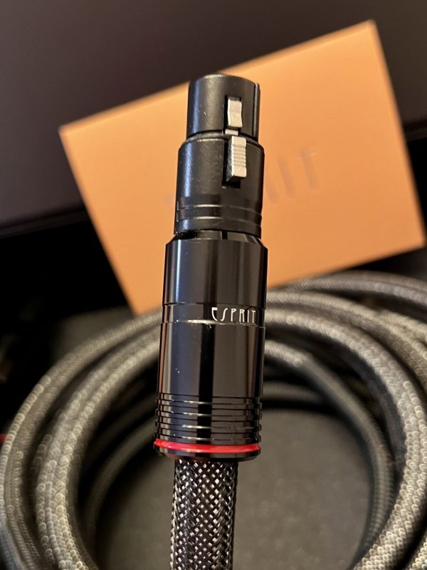

Today i’ve connected new Esprit cables to get higher level.
They aren’t at the same level of rest of Esprit cables in my system, but i fell sub needs lighter quality cables to work only below 80/70Hz.
