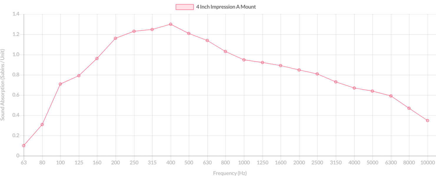

FWIW the diffusers I use are the 4" GIK "Impression Pro Series" (https://www.gikacoustics.com/product/impression-4inch-bass-trap-diffusor-absorber/), which, according to the company have an absorption profile shown below. (Although I don't entirely understand how it's possible to have absorption > 1.0, since, as I understand it, a value of 1.0 Sabins means all energy is absorbed ... https://en.wikipedia.org/wiki/Sabin_(unit) ).
According to GIK, the thickness mostly affects the absorption of the low frequencies, not so much the high frequencies ("The depth or thickness of the panels depends on the amount of low-frequency absorption desired. The thickness of the panel dictates the lower limit of absorption. As thickness increases, the amount of low frequency absorption increases as well. The thicker the panel, the greater the absorption.")
Thats a perfect example of why the reflected sound does not corelate with direct. Simplisticly you subtract that plot from the sound that hits the panel ... presume they are a diffuser as well so effectivly some hf sound not absorbed will be scattered, dropping level and changing phase. All works really well to calm down a room but theoretically not ideal at first relection point.
That 1.2 sabins / unit is probably a function of how they measured it ... but it gives a good picture of what it does
