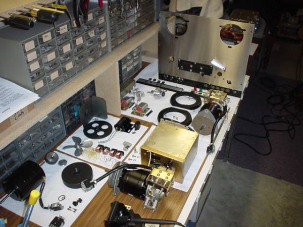

440B Rebuild
Hopefully this all adds back up to a 440B:
This is going to be my 'multi-format' machine, with the ability to play various tape configurations just by swapping headblocks and repro cards. The starting point was a B-series transport that had no discernible wear on any of the mechanics....the motors ran factory-smooth and only flaky brake assemblies hampered immediate use.
Still, it's a worthy effort to give the machine a complete tear down and clean the solenoids, relays, new brake shoes, and go through the mechanical setup and adjustments. All brake and tension settings are going to be on the mid-scale of 1/4" to 1/2" range, to accommodate both tape widths with the trend more biased towards 1/4" use.
440s are easy to rebuild, parts are plentiful, and they sound great once set up properly. The biggest drawback I've seen is that people run the heck out of them, and whatever appears on the used market is typically in a state of disrepair and useless to the average fellow that might have an interest. That's too bad, because with a little work they can be decent machines.
Tom B.
