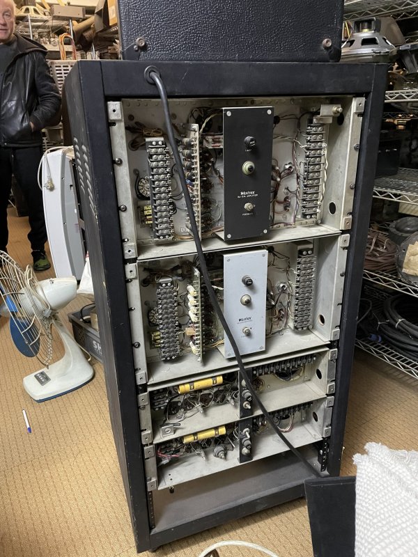

I owned the Westerex 3D cutter mounted to a Scully lathe, using the Westex 1700 series mastering electronics package. The RIAA pre-emphasis module was carefully matched to the actual cutter head to correct for its characteristic: they were very serious about getting the RIAA characteristic right and didn't want variance in the cutter head to influence it. The idea that a different EQ was used after stereo LPs were introduced becomes ludicrous if you've had exposure to any LP mastering system.

The cutter head has nothing to do with the EQ. The RIAA pre-emphasis module, which is part of the mastering electronics, does.
The Westerex pre-emphasis module also includes EQ calibration that is specific to the individual cutter head. The two bear the same serial number and should not be separated. The module equalizes to compensate for the cutter head itself, then applies the RIAA characteristic.

Those amps make about 125 Watts at full power. The cutter head gets fried if you send it more than about 10 Watts. They did this so the system can't be overloaded or anywhere near it, with any kind of groove that can be tracked by the best tonearm/cartridge combo that might exist. In fact the system can cut undistorted grooves no pickup has a prayer of tracking.
Put another way, most of the limitations of the format are in playback, not record. That is where most of the 'distortion' of the LP occurs too.
