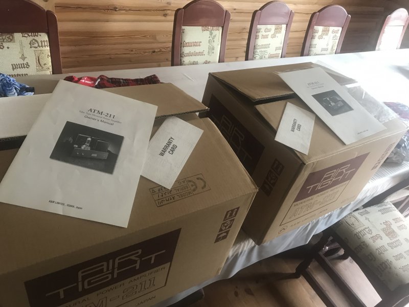

I have the possibility to get a pair ATM-211(at a very good price) but not sure that they will be quiet enough on my Altec VOTT s.
Not sure either but they are fine looking specimens.
Mine are extremely quiet. Using with Horning (99db) and Zingali (98db) speakers. Your Altec's are a bit more sensitive, but I have not had an issue with background noise. Dead quiet. Using Air tight ATE 2001 pre.
Thanks for your reply. My VOTTs are a bit more than a bit more sensitive.
