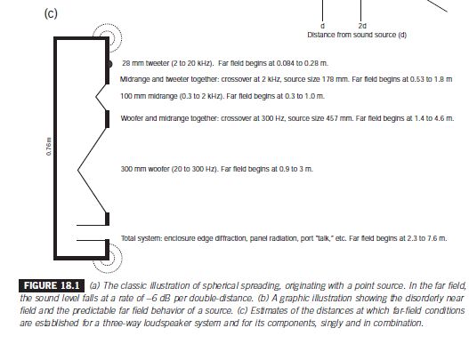

I don't think they were specifically designed to be heard from 8 to 10 feet, either, Mark. Did you Def Techs come with instructions telling you how far to sit from them? I think there is a point at which the sound of any given speaker's drivers will cohere, making them sound like a point source and not a stack of individual drivers. That point is very close with small two-way speakers, farther away with big 3 and 4-way floor-standers, can be farther still with some horns, but it's just common sense. I can't recall ever seing it published as a specification.

Tim,
As we agree on these points I can only post a figure from F. Toole "Sound Reproduction" that illustrates you first point, showing that these distances can only be estimated approximately from speaker dimensions.
