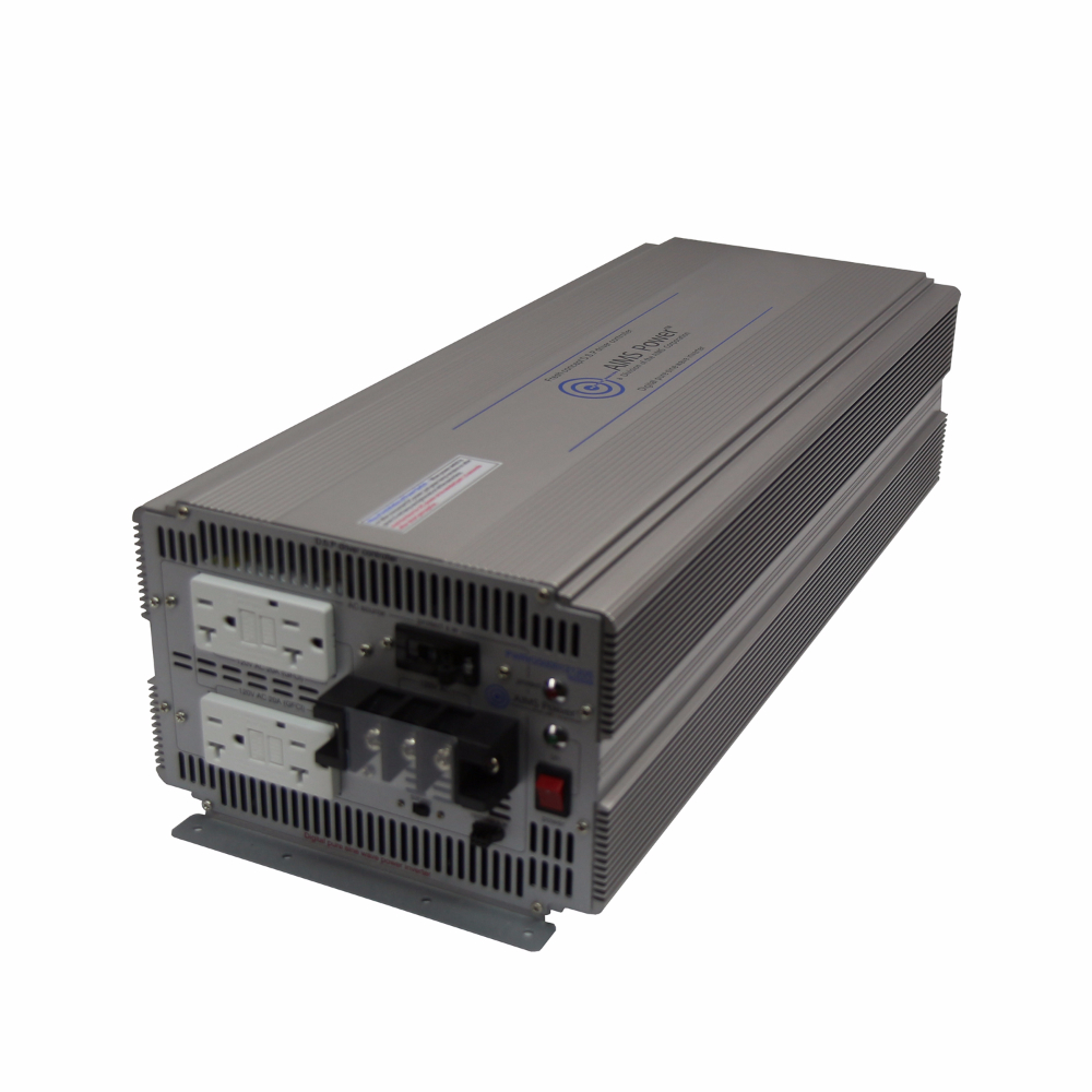

This may be better. Lower distortion than the industrial unit. Not fully sure without calling.
If I'm reading this correctly, with 240 volt split phase out, it could be wired to a copper loadcenter to keep the equipment out of the room and only duplex in the wall. But really, if I was going that route, I would use a Victron with 20,000 watts output.
