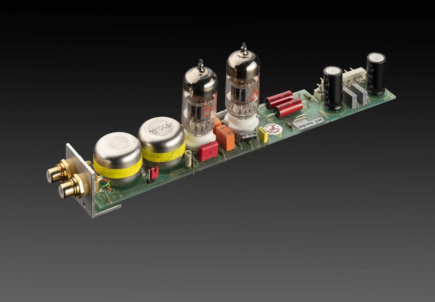

Here a smart mc two stage design with sut from haufe that sounds phantastic.mc_modul.jpg

Here a smart mc two stage design with sut from haufe that sounds phantastic.View attachment 152036
Nice! Looks like it needs a power supply...
Yes..i use circut board with silvercore sut( included in the housing) +seperate powersupply.
Kind of cute and space-saving. Gain 64dB with 1:20 sut/mm 38dB.20250211_170519.jpg
Width 18cm deepth 23cm
separate mains transformer key switch anode voltage 40
seconds delay
