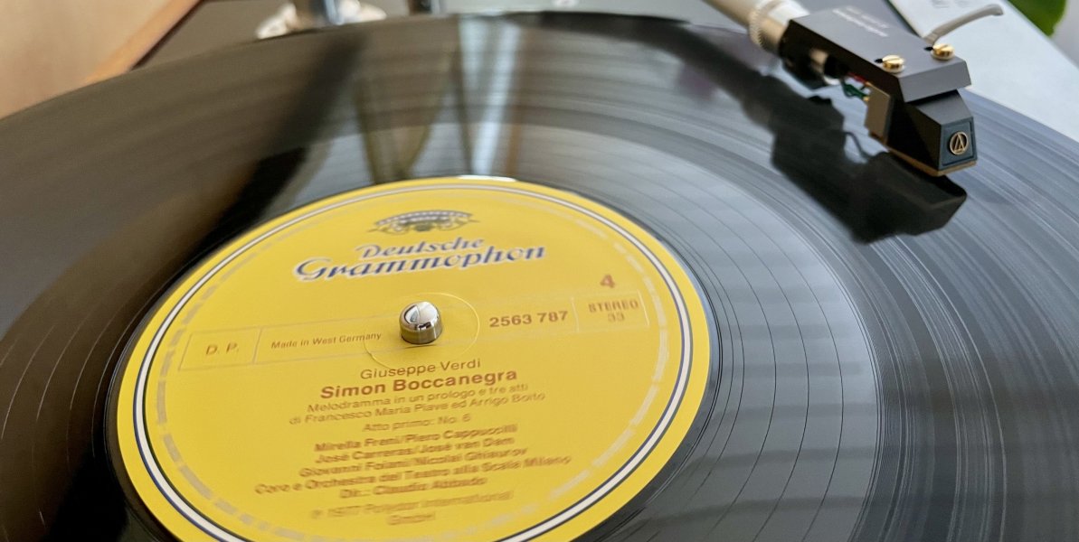

Right now an AT-ART9XA in an AT-LH13H. Works very well indeed.
Indeed. My first thought was «explosive».
Reactions: Robert Young
I wonder how nuch of that is due to A-T’s design to reduce magnetic interference? The only other cartridge i’ve used with that kind of awesome dynamic drive and speed is a Micro Acoustics 3002, which is an electret…
It’s great but I wish they would put a MicroLine needle on it. Sounds to me like the Shibata may have trouble with end of the side operatic climaxes.
They could all it the XM. Three Scania truck style cartridges with Citroën style names.
