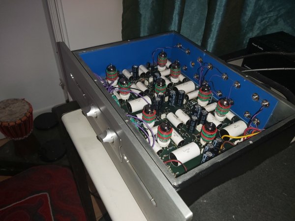

hello, i have some questions regarding tubes in the cat i have ,here is the picture , it does have a legend front panel and left /right volume switches just like in the legend not volume /balance .
(some in between design???)
DSC_0454 by andromeda61, on Flickr
If i look at the print the left section would be phono and the right linestage .
the linestage is quit, the phono not so anymore , it was a second hand unit when i bought it .
The tubes in the phono section are from several brands , JJ EI Sovtek and tubes with only a typenumber/letters
Any body any recommendations on a nice new set of quit tubes , the same type of course , although i dont know what has been changed by the previous owner so i might alter brands .
Ive cleaned all the switches with contact cleaning spray and the line /phono switching noise seems to have dissapeared , also the sound seems to have improved by cleaning the switches and in and out puts
The sound is phemenol still , the tube sound quality is still very good , this audiocomponent amazes me , or maybe it was just that an improvement over the nagra plp which is no competion for this thing , this is a complete sounding musicmachine from the bass to the the top
I m gonna also clean the tube pins and sockets

After having bought this preamp in 2012 and having expiremented with all kinds of NOS tubes ( were they new NOS in the first place thats highly questionable ) and genelex gold lion tubes , i decided to go cheap this time and not take the audiophile route.
My tubes got noisy and needed to be replaced
Here in europe there is a big electronic online retailer called CONRAD .
I bought my ECC 83 and ECC 88 online and i got them a few days ago (at least you know these are new ), i also ordered KONTAKT 60 electronic cleaning spray , priice around 180 euro for 10 tubes plus a couple of spares
Its a 13 year old pre so i can imagine its good to remove oxidation , so i removed the tubes sprayed in all the sockets , stepped volume attenuator , rca contacts .

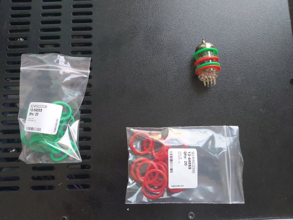

After waiting some hours and putting the juice back on , i had tube ringing for the first hour or or so , i never had that before with the CAT pre, i switched some phono tubes for the line stage ( identical tube setting ) and put my finger against a tube to prevent it from ringing , after about 1 hour it all settled and the pre sounds better then it has ever sounded before .
I also changed the interconnects for the first time in 10 plus years , i didnt go to an audiophile store this time but i went to a studio /music equipment shop and i bought Roland studio black line rca cables 18 euro s for 1 meter .
Conclusion in this situation i think tube dampers wouldn t be a bad idea .
Layering improved ,clarity improved , noisefloor is off course lower and the soundstage expanded with better image separation .
I know its sounds diplomatic , but its just how it is lol .
I think this oldie now sounds better then it has ever done before .
Ps the interconnects were transparent link 200 cables , probably also with a cap parallel in the ( black box ) , caps dry out over time and regarding the latest disccusion i decided to get rid of them all together , no more mysterie boxes in my system .
