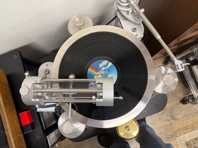

A few thoughts on TT2 setup :
Clearaudio recommends a distance of 62 mm from center of carriage to stylus. This is hard to measure. It is easier to reference the distance between the positioning pin and the rail in front of it. About 2 to 4 mm seems to work pretty well. You tighten the arm into the carriage by lining it up so that the set screw is accessible through a hole in the dust cover. You twist the arm in the carriage to set the azimuth. Tracking force is set by attaching an eccentric mass to the rear side of the arm. Several masses are provided to accommodate a wide range of cartridge masses. For the 7.5 gram Jubilee, I am using the 2.25 gram mass to set tracking force at the recommended 2.8 grams.
Clearaudio provides a tiny circular bubble level for checking azimuth and SRA. It is very light, but it is prone to fall off the headshell. I bought a 6 pack of very small circular bubble levels on Amazon. They have adhesive, so they stick in place. They are easily removed, can be used again, and are potentially useful to check level on other things, like speakers.
Clearaudio provides a linear gauge to help with alignment. This is the most tedious part of the job. You set the stylus on the gauge at the run-out groove, and then cue it up and run the cartridge back to the run-in groove to cue it down and see if it’s on the line. If not, you tweak the arm board and check again. It might take you four or five iterations to get this right. But it’s critical.
When you’re setting the arm’s level, it is really important to adjust the grub screw first, and the support pillars second. Get the bubble centered. If it’s not centered, there will be a slight tilt. The side with extra space between the bubble and the mark is the lower side. You should not have to run downhill if you’ve got the other adjustments right.
You can set VTA on the fly if you want to. The arm is very solid, and the adjustment is made with a knob.
If everything is right, the needle will cue repeatably and precisely. At the end of the side, cue it up, move the carriage back to the outside with the positioning pin as your handle, raise the arm off the record, and remove the record. The arm stays in the vertical position until you release the catch, and set it down again.
It took about two hours to set it up from the time I started removal of the Charisma to proper installation of the Jubilee MC. That’s really not worse than a uni-pivot in my experience. I think once you’ve mastered the linear alignment, it would be faster. Perhaps less than an hour. I’ve only done this twice, but I’m very pleased with the smooth function and the sound I’m getting. I will probably tweak things one final time once I’ve got 50 hours on the new cartridge.

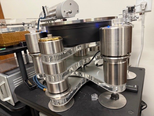

The Transrotor ZET-1 with out of the closet Souther tonearm, where it was safe-kept for over ten years.
Reactions: Another Johnson
A big difference between the TT2 and the Souther designs, aside from the obvious mass difference, was Lou’s use of that support on the spindle.
It was a really cool arm, and at the time it was considered one of the very best possible matches for the VPI flagship model.
In 2017 I tried to buy one that was claimed (on eBay) to be NOS, but when it arrived, it was not. As a former dealer, it was not hard to spot. Buying through eBay gave me the protection to get a full refund.

Regarding the Souther support on the spindle, this is an interesting issue.
Obviously that bearing surface with the spindle rotating during play is a potential source of noise.
Clearaudio dealt with this in the TT1 and TT2. In the case of the TT1, they extend a gantry with footings on two of the three support pillars. No rotation, and really a very solid and well defined support for the arm carriage track. In the case of the TT2, they use a massive hinge that bears all of the carriage track’s load at the arm board.
I have had turntable specialists tell me that the TT2 is more finicky and they would prefer that someone who has the jack to buy a TT2 to just go ahead and spring for the TT1. Of course they would :p:p;)
I see their point. The TT1 is rock solid. The TT2 looks rock solid too … until you compare it side by side to the TT1.
I’ve been running the TT2 since early October. It has not required much in the way of adjustment. Since I installed the new Jubilee MC, I’ve not come near it with a tool. It has run flawlessly since this, my fourth, set up. That’s been at least 50 sides. The new Jubilee MC may have been hand selected. It is very enjoyable. Realistic, even though subtly sweet and warm. Excellent dynamics. I am really enjoying it. And then when I go back to the Linn/Lyra, there is no sense of disappointment or renewed ecstasy… it’s just an extended sense of “wow, this is nice too.”
I think if how it looks is an issue, it would be better to mount just one arm, and to choose the back right pillar. It actually looks quite cool there. But the Universal 12” was there first. Putting the TT2 on pillar 3 created set up, as well as aesthetic, challenges.
After two months of living with the TT2, I really like having it mounted as I’ve done here.
I am right handed. It is very natural to raise the TT2 at the end of a side with my right hand. The actual arm wand and cartridge end up on the back side, offering the cartridge protection when the arm is in the raised position by virtue of its position away from the front of the table.

I cut and shaped the carbon fiber board to the Acrylic Aluminum arm board and mounted this to the Zet-1 table. I then positioned the TQ-1 on the fabricated board marked the position of the TQ-1 base to the fabricated arm board removed the board drilled the holes for the TQ-1 base remounted the TQ-1 to the Zet-1 and voilà as they say.
Of course it wasn’t that simple but the end result is not bad. I have to pretty up the board a bit at some point but for the moment I’m relearning how to set up the TQ-1. Yes It ‘s a bit time consuming at first but not as bad as some may have read online. I will be listening to the Helicon as well as a Shelter cartridge. I’ll let you all know the result if there is interest.
