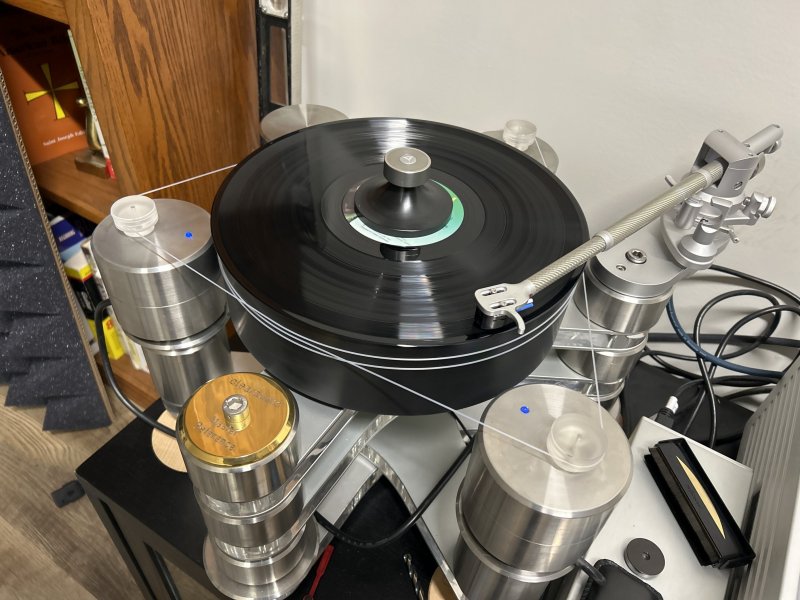

Does anyone else have trouble cleanly tracking Ron Carter's first bass note on Keep Your Eye on the Sparrow (Side 1, Track 2) from Dave Grusin's Discovered Again?
I have never been able to get that first bass note reproduced cleanly. I've tried 4 different copies (1 US, 1 German, 2 Japanese) and they all have trouble on the first bass note. I'm wondering if this note was too hot when they cut direct to disc. The issue is a slightly buzzy sound on the first bass note. I don't think it's coming from one side, but centered.
My setup is a Brinkmann Taurus with 12.1 tonearm, Hana Umami Red, Cardas Clear Beyond Phono cable, VTL 6.5II phono stage. Gain is set to 56dB and loading is 470ohms. VTF is 2.05g, table is level, AS is set using Peter Ledermann's method. Geometry set using Brinkmann's protractor. Azimuth is set using Fozgometer V2 and visually confirmed. The Hana is new and only has 18 hours on it. Does anyone think the cartridge needs to break in more to become more compliant?
I don't have any mistracking on any other records, which leads me to question whether this is just inherent to the recording. Appreciate any insight!

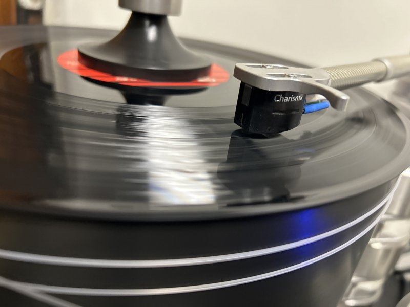

No problem on my copy (bought at first release). Clearaudio Master Reference with Universal 12 and Charisma V2.1.

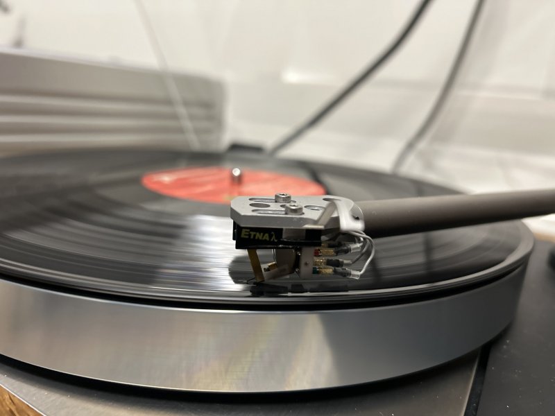

I looked up the Umami Red tracking specs. They are typical of many moving coils, but low overall. Im going to try it on an LP12 with Lyra Etna Lambda when it gets to the end of the side.
Klimax LP12 with Lyra Etna Lambda. Very clean again. I can’t find tracking specs for this cartridge, but I think it’s at least 80. Umami Red is 70. Charisma is 90. The old Shure cartridges would track over 100. As you’ve noted 70 is fine for 99% of recordings.

FWIW, the Etna Lambda costs about twice the price of the Umami Red, while the Charisma V2.1 is about half. The Etna Lambda tracking force is 1.72 grams. The Charisma V2.1 is 2.4 grams.
It may not be related with the issue here but unfortunately Peter Ledermann's AS method is wrong. It still worth to try more and no AS for the sake of experiment.
I think I figured it out! The anti-skating was pretty far off. It was too low. I played Norah Jones’ Come Away With Me Analogue Production reissue and noticed her voice was a bit smeared across the soundstage and I was getting break up in the right channel. It took a few tries to dial in the anti-skate, but when I did the change was huge. Her voice shrank to near pin point accuracy and was pushed back into the soundstage a bit. More three dimensional. The breakup in the right channel went away. Tried Dave Grusin and that tweak all but eliminated the mistracking on that first bass note!
