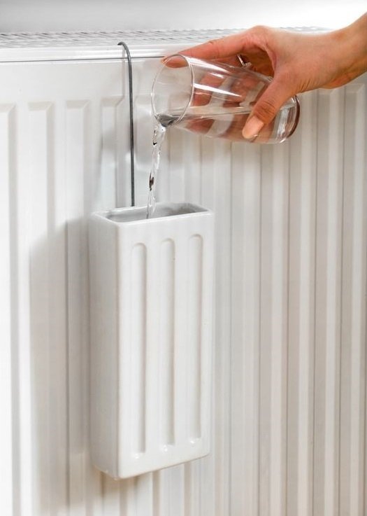

Static charge has a lot to do with indoor air humidity. Houses with air conditioning often experience this, and also in winter when the heating system removes humidity from the air below 40%. I've never had any problems with it with water tanks on radiators.13007de5a226d26b698c99de30c62cc5.jpg
