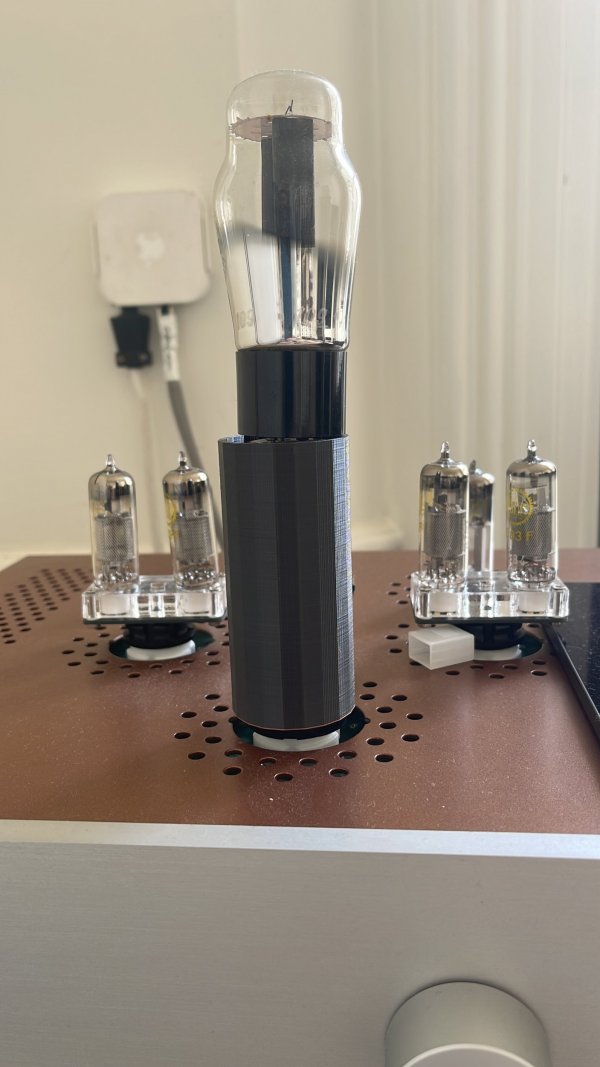

It’s a lot of money I know but the improvement in sound quality was like moving up a couple of equipment levels. It’s quite an extraordinary valve but I didn’t hear what it was capable of until I changed the rectifier away from a Tak274b.

If those were Siemens, then they originally came from me! I'm not sure I can add much to what I have already written, but I will tell you that the nickel plates Tungsram are very expensive (eur1400 for my last pair) and pretty much unobtainable. If you speak to Rikard again, he is also having good results from 1950's ecc40 and they can be found quite cost-effectively. Sonically that one lands somewhere between the megabucks Philips and nickel Tungsrams.
Thanks Marc! I have tried the ecc40 but i find them being a bit "thick" sounding in my system... Really like the E80CC and wants to explore among the different ones. When I asked for more information I meant information that made it easier to buy the specific tubes you were describing as year, code.... For me the tube world is a jungle and I'm having a hard time to figure out if all the "red label" Tungsram is as the ones you reviewed or if it is specific ones....

I’m not clear which model of e80cc you have there but if it is Siemens labelled with rhodium pins then it was made by Tungsram. If however it has gold pins then it would be Philips Heerlen production. I prefer the Tungsram as it is clearer and higher resolution.
The regular Tungsram production had yellow print on them but the better testing examples had red print and were aimed at industrial users. I’m not sure which of these would have been supplied to Siemens.
My general rule with buying tubes is to try buy the oldest examples because they were made to higher standards, before the introduction of transistors led to cost cutting.
With Tungsram tubes, they usually have a little silver tag inside to indicate the date though to an extent this is less critical in valves made inside the ‘iron curtain’. For Philips tubes, you will find date codes printed between the pins but they will look like hieroglyphics unless you refer to online lists.
Before we go much further though, it would be useful to consider your budget as some of these rarer pieces with pinched waist and D foil getters are expensive, with a capital ‘F’! That money could be better spent elsewhere in your system and fwiw lampi dacs are very responsive to clean power (Cord / fuse / rectifier) so it may be better to pick some low hanging fruit in these areas first. @VoicesInMyHead is very knowledgeable in these areas and I’m sure will be happy to guide you.

I do like e83f instead of 6sn7 but feel that it works better with a denser sounding / solid plate rectifier. Am very much enjoying an early viennese production tungsram pv4200 along with the valvo d foil e83f (and nickel e80cc)
Reactions: JP Borglin
You probably won't find one easily however I am told that the Budapest built barium version is very good. The Valvo g2004 solid plate / ST shape is also a decent contender and is easily available at low prices.
