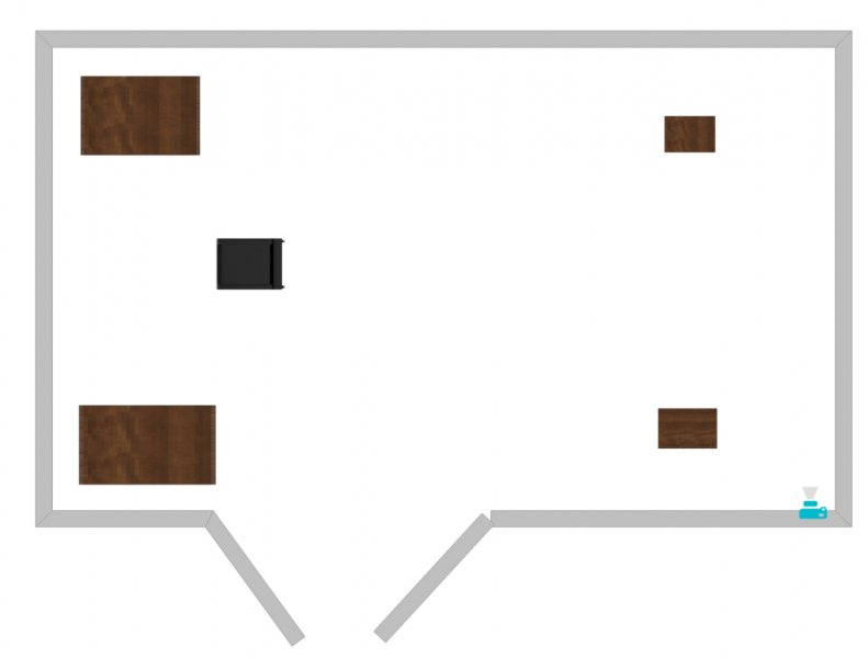

Here‘s a rough (not exactly to scale) drawing of my room with the speakers on the right, the main listening seat, and the two racks on the left.
Note the inset entryway. Here’s what it could look like when I’m done with the construction.
A bit of a change - I’m going to go with a single entry door. That will get me more wall length in the bottom left corner. So I could stick with two racks, but that would mean I’d need about a 16’ run of XLR IC from the phono pre (lower left) to XP20 (upper left). I’m already going to have to deal with a long XLR IC from the ‘20 to the monos, so that’s a lot of expense that I could in theory avoid.
However, that upper left corner? There’s a window on the long wall right behind that rack position. If I stick with two racks, that source rack would be short enough to allow use of the window. If I go with one larger rack, that is a problem. Also, if I put everything on one rack there, I’d have to pull it so far away from the wall on the right to be able to get on either side of the TT that I may as well not even have a window there. There are some WAF considerations I have to accept.
So it would seem the “right” place is the lower left corner in a single rack solution. With one entry door that gives me plenty of space to center the TT for access on either side, and with no height restriction I’m good there as well. But that means the cables to the monos have to run right across the entry threshold! :eek: So, is there such a thing as a “thruway” threshold cover that will let me run cables underneath it? Is this my best solution? As a reminder, it’s already decided the equipment will not go between the speakers.

@sbnx and @PeterA , the room is 14’ wide and 16’ long (9’ ceiling). PeterA, in fact the one and only listening chair will be replaced with what Crate & Barrel calls a “chair and a half”, actually a small love seat suitable for three (if there isn’t too much excess weight ;) ). So given this, what’s your thought on the equipment location?
Hmm. That would put the equipment rack at about the first reflection point on the left side. The rack would come out from the wall by 24” (room for the cables behind it). My left side E SE‘s outer edge is 26” from that sidewall. A possible problem?

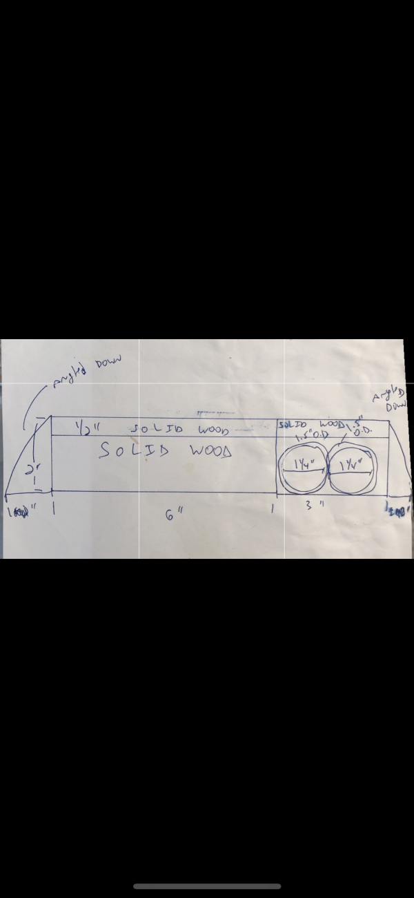

Ron, do you have a picture of the solution? I’d love to se it!
I do not have a picture, because I have not yet been able to arrange to have a carpenter I found on Thumbtack visit the house.
But imagine a natural walnut top which is about 6 inches wide, and sloping sides. This is an early, bad drawing.
The walnut saddle or threshold thing I'm talking about will cover the gap between these two sidewalls and cover the cables running through a plastic cable raceway.
Got it. Thanks @Ron Resnick!
I’m partial to using the lower left corner, and this sort of way to deal with the threshold could make it work. It will keep the equipment off either of the sidewalls directly forward of the speakers, which I think would be better.
