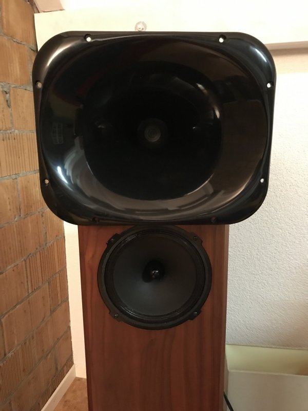

I have the Supravox 285-2000 EXC in my upper bass horns (60-600Hz). They blend seamlessly with the midrange. How they sound will be highly dependent on the enclosure, crossover, etc… so not sure what you are asking @Rensselaer?

I have the 215-2000 Alnico drivers mated to a Beyma CP755TI compression driver in 18 Sound XT1464 horns. Soon I will have solid wood Tractrix horns to try with them. The Supravox is in a TQWT cabinet.

It looks like they are in a TQWT, for which they are ideal. I have run mine fullrange but they are just not extended enough in the highs and you have to sit with your head in a vice to get acceptable highs. I am basing my DIY design on this model from Supravox:
In room response is down flat to 35Hz and useful to 30Hz. I found I prefer a compression driver above 1Khz-20Khz. When tuned correctly I get within +-2db from about 200hz-18Khz.

Have I heard the field coil 215-2000 exc? No I haven’t but cone geometry and design is identical other than magnet so, while exc version might sound more pure in some way, the high frequency extension shouldn’t change. I can tell you that the bass quality and punch from this driver is very good in a TQWT cabinet (the guy in the video used Supravox designed cabinet just like mine).
It is not issues per se, it’s just physics. An 8 inch driver will beam like hell at high frequencies. It’s fine for some and at least it isn’t nasty in the highs like most Fulleange drivers with a Whizzer cone.
Look at the Cessaro Opus-1 speaker. They have their own version of the Supravox 215-2000 Alnico (they still use the original in the Wagner) and they also choose to match it with a horn tweeter (same with Wagner). A good compression driver to my ears just sounds more realistic up top in a good horn (probably where your ALTECs are letdown).
