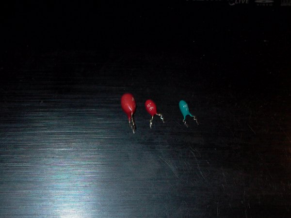

You are right but I am not doing in exactly 1/10 down because of the value of caps in my stocks. the original is 47mf but now is 100mf tantalum 6mf oil 0.5mf oil+ 0.05mf film.that you can see in the picture connect in out side with a plug in, we did ABX with plug in and out, result that never unplug again. I check the price of oil cap in Ebay, they are asking too much to-day and I almost done in my stock. add choke maybe another idea

The original repro broad by pass cap 47 is electrolytic , we change to tantalum 47, sounded better, next changed to 100 uf tantalum even more better, that is the sound of copy we sent to you. final we added 6 uf and 0,5 uf oil + 0.01 polypropylene in parallel, out side the case connect with wire plug in and out. check by listening. that sound is V's tape.
3 of coupling cap 47 tantalum change to Solen metallized long time ago after we did in record broad parallel add 0,47 uf paper in oil copper on those coupling cap got the much better result then we will do the same to repro too in next . in future release will be in different level again

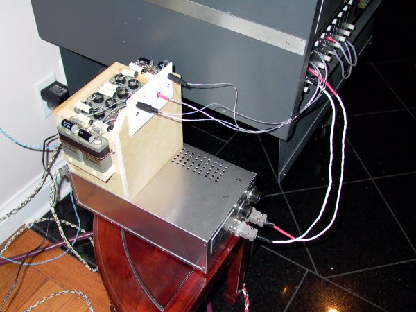

Since last time ,modified A80's repro card's C18.C30 by pass caps of the second stage with great up grade of sound, there are so many caps using in the first and second stage ( last output stage had been converted to tube and transformer so no coupling cap in using) and they works as coupling or by-pass, different construction of caps has their own sound character specially working in sound path coupling with big effect , C8 C16 C19 is the coulping, stock was using polarity Tantalum 47mf and 10mf, non polarity cap in 47mf must be very big in size only metallized plastic cap can make that so we converted three of them to Solen metallized long time ago that sound much better, but to-day Mundrof make silver/gold/oil metallized cap in same value , after we replaced Solen to Mundrof , that sound even more better, with oil in, sound more smooth . next,we add on Jansen paper in oil copper foil 0.47mf and 0.01mf multi cap (polypo) to C19 C16, it came out sound more clear but too much in high frequency with cool that cover the oil cap's smooth and warm sound, finally we took off the Multi cap then got the sound which we like better,C8 is the output coupling of first stage is more sensitive than other two caps C16 C19 so beside the Mundrof silver/gold/oil , we added a Jansen silver foil paper in oil 0.1 to it and got the best result. finally we did the same thing of C18 C30 to C3 C9 too which is the by pass cap of first stage, right now this is the best sound we had heard so far and will keep it on for a while because no ideas for more modification . maybe it is not Studer's sound any more but for our tape copy quality will have a big jump and will be noticed by our future copies

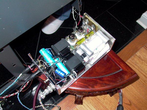

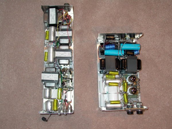

Recently we did live concert recording of young violinist Tatsuki Narita and pianist Mami Hagiwara with new re-modify A80's record amp, from the pictures which you can see the big cap in white colour is Mondorf silver gold + oil (47uf) combine with silver colour is Jensen paper in oil copper foil (0.47uf)and colour in gold is paper in oil silver foil(0.047uf) to replace the stock use small Tantalum in coupling position, market value is $6 to total $400 of each one, first and third stage still keep in tube version as before, also the repro amp did in the same way too. result big jumped sound quality in master tape recording unbelievable detail and transparency . because of waiting for the shipment of RMG900 blank tape that we can not copy tape to go right away so we did some CD copies from the master tape and sent to some of our subscribers looking for some feed backs, they all came back of unbelievable quality.
I used the Carmen fantasy piece from the CD copy compare listen to the EMI vinyl old Perlmen's recording, although my Lp system is not the real high end level but the CD player is more simple, a Toshiba HD DVD player, and this is the first time I like the CD sound better than the LP but by no mean CD can bit the vinyl, key point is recording quality if we can have a vinyl cutter ( my dreaming) and direct cut a vinyl from the same master tape the result will not be the same !later Ed will put new samples to the website for people can compare the changed quality to our old one
