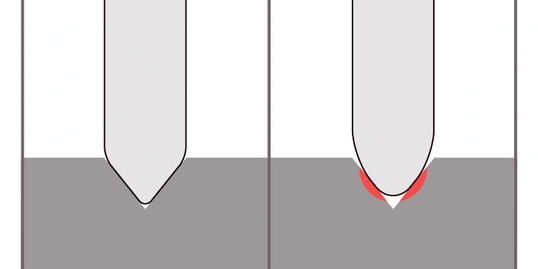

I don't see how this can work given the scales of things. For detail and resolution, theoretically at 60dB of resolution, the stylus has to resolve the groove down to 20 nM. The wavelength of a red laser is 650nM. Even an excimer laser that is in the ultra-violet has a wavelength above 300nM. There is no way that an LP cut with a laser can be "high resolution".
According to the patent, they are using laser ablation. You can get features down into the 10s of nM range without having to resort to exotic lasers.
The real problem is whether or not we can get titles that are transfers instead of shitty remasters.
Reactions: marmota
"Laser ablation" just means removal of material using a laser. I haven't managed to find a copy of their patent. The pictures on their website show the gross measurements for LP grooves. The picture is correct - and it measured in micrometers. The smallest dimension of about 10uM is the peak to peak distance of a waveform in the groove. A red laser has a wavelength of 0.65uM, so it can reach the frequency response required to cut music-frequency sound into the grooves.
I am referring to resolution - if you can hear a difference of 1dB between a louder sound and a softer sound, the displacement difference at the stylus is about 10 nM or 0.01 uM - at any frequency. Since the laser is pulsed light, you would have to abate the laser at that resolution.
The patent is linked to from their website. (Actually, in the comment from Techspot at the bottom of the page.)
By itself, the beam can't be focussed to the size required. The accuracy required to cut nanometre features is achieved by precisely adjusting the duration of each laser pulse. Positioning the beam to the required accuracy is achievable too, it's done every day for "cutting" blu-ray masters.
