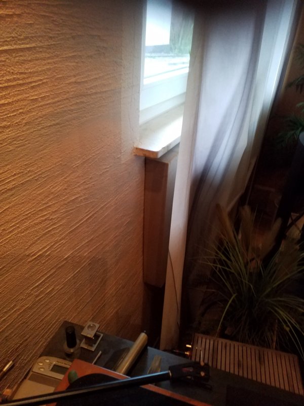

What kind of absorber e.g. Basotect? It doesn't bother them at all unless you use thick velvet curtains. If you can blow through the fabric and feel the air on the other side, they work as usual.exsample behind curtain20250106_111507.jpg
