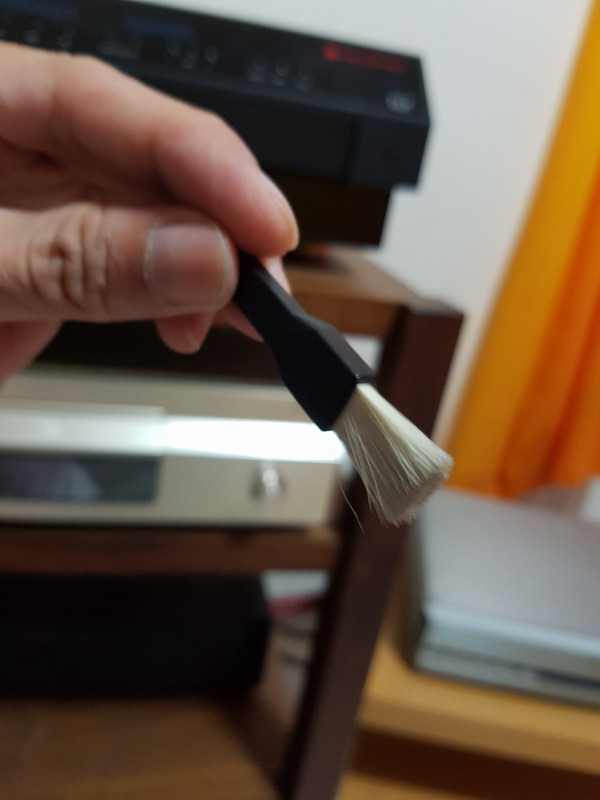

Another useful tool is a soft 00 size artist brush, either with stiff bristles or cut off to give the bristles some stiffness. Upon inspection with magnification you can often simply brush off any accumulation on the stylus without using fluid. I try to avoid cleaning liquids on the stylus.
