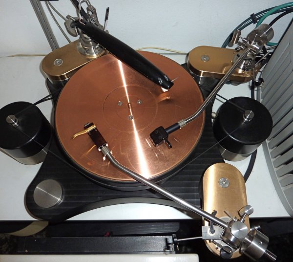

If you look for my thread about the Melco 3560 in the turntables section, you will see the FR66S with Koetsu Onyx, which to me sounded very right.. The owner's are my friends who did have Koetsu rosewood too but preferred Onyx so sold rosewood. Hope this all helps you

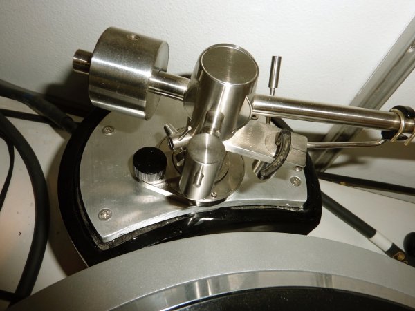

The Micro Seiki AST 10 base weight will work on the Ikeda 407, correct?
if you have the standard ikeda 407 (not B60 VTA lifter) mount, the AST 10 will work. If you have an original Micro Seiki gun metal AX 6 base , this will even be a perfect blend of material.

Off the wall, but does anyone know the Stud specs of the Ikeda shaft? Maybe I can just order a large Stainless Steel Nut.
A supplier told me that the Micro Seiki AST-08 will not work on the FR/ Ikeda arms. I really don't want to buy it and it not work. I have never seen a picture of anyone using a MS AST-08/10 on these arms.
