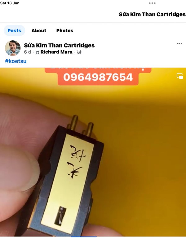

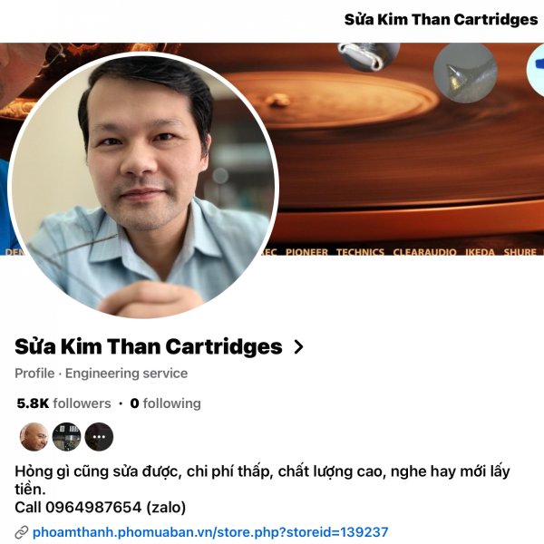

Check this Vietnamese repairer. He seems good & v reasonably price . Search him out in FB & Pm him
