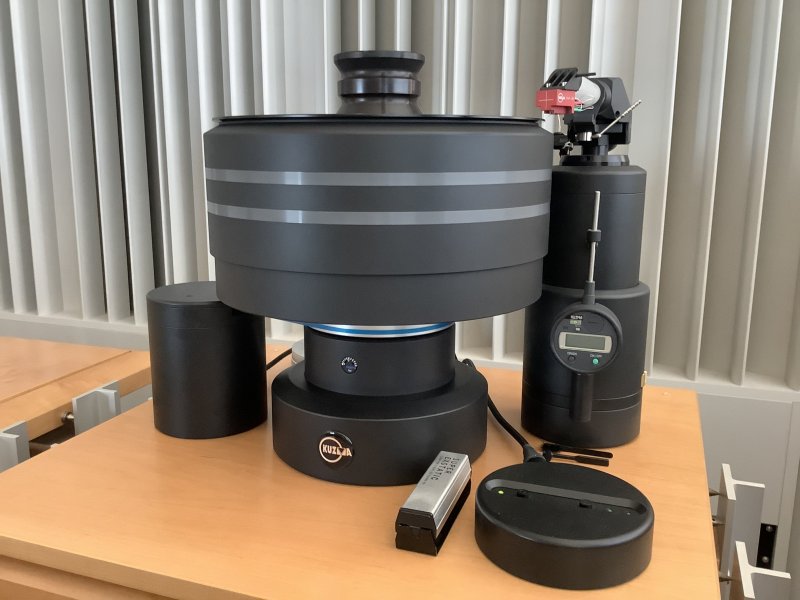

Assembly…
IMG_2080.jpeg IMG_2086.jpeg IMG_2088.jpeg IMG_2100.jpeg IMG_2105.jpeg IMG_2102.jpeg

Ooo in matt black.....very nice 'Marcus' :)
And with the Safir 9 arm too..very very nice.....drool.....the XL Air and Safir 9 look like a match made in heaven both technically and aesthetically.

Safir 9 and XL Air are indeed a match made in heaven. I’m still in shock how huge and fundamental improvements the Air kit made to my system. Can not believe only the air bearing is responsible for such a radical transformation in sound quality. More to follow…
