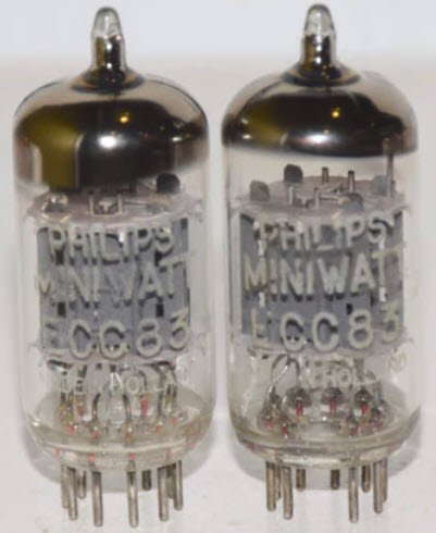

Im using the French Mazda tubes for linearity. The valvo ones are warm. The tele tubes are very warm.

Are you referring to a smooth plate Telefunken?
I think so. I dont remember which ones i have. I tried two different types but kept only one, with gold pins
