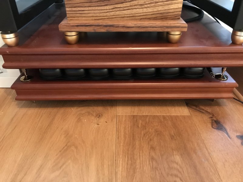

I would not bother with maglev stuff! I tried the heavy duty will spike ones some 12 yrs ago under my TT they were quite detrimental also tried the ones you have linked to, no good as well under various ancillaries.
As I have had my TT for some 30 yrs, I find the airbladder as in the photo to be highly effective in opening up the soundscape like I would have never believed, all for approx £20 ! You could try the same if you were to get 2 platforms and experiment, the cushion will take over 100 kg.BTW it makes a mockery of the Goldmund mechanical spike on the TT stand, lol.

Could you please expand a bit upon the construction, not much is seen from the pic. And why are there spikes too?
The spikes allow me to slide in the airbladder to the desired position, it is then inflated so the spikes/platform is lifted a few millimeters above the lower platform, the TT platter is accurately leveled by the TT pillars/suspension which rotate for this. The inbuilt TT bubble level is then zero in and just serves as a reference if the bladder has deflated a little, approx 4 wks or so, then just inflate slightly again when required.
