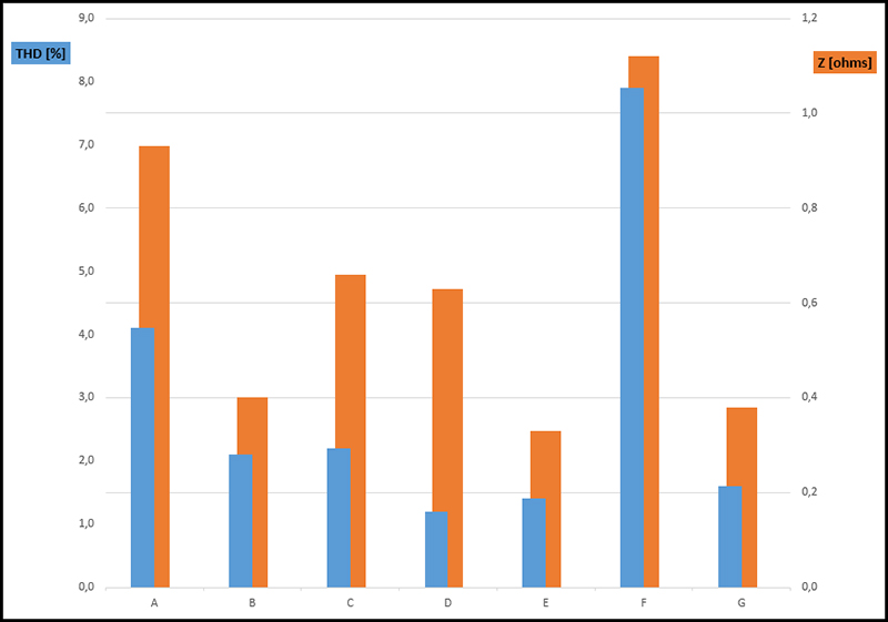

Here are some results from measurements made by my friend Peo.
The measurements are made in seven different hifi systems in typical cities and towns in southern Sweden. One of them is in my home.
The measurements are made directly in the hifi powerstrip/conditioner.
The blue columns show THD in % and the orange show the pre impedance in ohms.
Having this in mind, it is quite understandable that putting a new super duper power conditioner in homes B, E or G is not such a big effect (except on high frequencies) compared to homes A or F.
