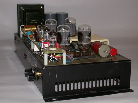

For certain it could be done with the Martin Logans. The polarzing voltage and capacitance of the panel come into play. You can use different types of tubes dependent on the current requirements for the panels.
I have modified mine to experiment with the QUAD USA monitors and it works, I have not spent the time to vet out how to deal with my ESLs because they have different requirements for the treble and bass panels.
This technique has been used on Acoustats as well. Martin Logans are really no different.
Since you are in California I would suggest that you could get in touch with Roger Modjeski he can certainly design something custom for ML easily . One of the local fellows here has CLXs and they are phenomenal for what they do well. He has CJ amps on them.
I don't currently have a good pic of the amp but it all looks very "experimental" in the picture attached below the Otari- It has been totally reliable over the almost 3 years I've been using it. You really won't find an amp like this commercially available because of the perceived risks of the high polarizing voltages going through wires on the floor. With a dedicated room and careful dressing of the cables there is no danger as its relatively low current.
I will soon be looking at mono blocks to make things tighter looking.
Thanks.

You have a manufacturer in Holland who sells this type of amplifiers for Martin Logan - see http://twinstaticaudio.com/elektronica/twin-otl/ Unfortunately Soundlab's seem to be out of the range of these amplifiers - they need around 9-12 KV HV with around 8kV peak to peak voltage.
