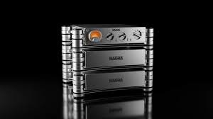

Is Nagra HD a natively differential circuit? True balanced input to true balanced output with true differential circuit in between?
Thank you.
Hi no-it is a single ended gain stage. But has optional input and output transformers for either balanced sources or balanced amps.
I found fully balanced sources such as my prior dCS Vivaldi preferred the input transformers. My current Nagra Ref DAC is inherently singled ended, I tried it both ways and prefer the input transformers removed. I've done the same on the output, and prefer using the balancing output transformers with my amps.

Does anyone know the specification of the Nagra HD preamp regarding gain? Oddly, I cannot find it on the Nagra website specifications list.
The owner of the HD preamp I was considering buying indicated that he thought it was only 8dB or 9dB of gain (which, if true, is not enough gain for the gain structure of my system).
"Maximum gain is +5.6dB (RCA in/XLR out) or –0.4dB (XLR in/out) and is unaffected by the ‘Studio’, ‘High’ and ‘Low’ input settings on its rear. "
From https://www.hifinews.com/content/nagra-hd-preamp-preamplifier-lab-report
Nagra does not list gain in their specifications.
Microstrip, I guess that they meant to say was it's +5.6db from 1v, 2v or 10v. So obviously +5.6db is louder from 2v setting vs 1v?
I have my HD Pre and Amp set at 1v. Never go past about 2 o'clock on the volume control....so in my context I have more gain than I need at the lowest output voltage setting.

Many preamplifiers have excessive gain - we have to use them around 10-11 o'clock. It looks your Nagra is being used at an excellent setting. As far as I remember the output impedance of your preamplfier depends on the volume control level, being minimal at maximum level, as could be expected from a stepped output transformer.
Thank you for this. That's even lower than my seller thought the gain is.
Well I'm sure as heck glad I didn't get involved with the Nagra HD preamp! Only 5.6dB of gain is pretty wacky from a flagship preamp marketed as a general purpose line stage.
Nagra should market this explicitly as a "low gain line stage." No wonder they don't disclose in their spec sheet the gain -- a rather important specification for a line stage pre-amplifier!
The only other time I saw a gain spec this low for an active line stage preamplifier was my Hegel P30A with only 5dB of gain for a solid-state preamplifier. Unsurprisingly, Hegel, like Nagra, did not include this spec in its list of specifications for a product advertised as a general purpose line stage preamplifier.

Hi Ron did those two 8 db gain preamps have multiple output voltage settings? In the case of the Nagra HD I don't think your conclusion on gain (alone) is the whole story to mate properly with your amps...
Nagra's marketing info is pretty bullish "...output impedance is as low as 0.2 Ohm so that you can drive any amplifier on the market."
Final point, I am pretty sure the output transformers deliver another +6db of gain....which is why I am at the 1v setting ....

The HD PREAMP HV offers a solution to this problem by providing a variable input level on one RCA and two XLR inputs. A toggle switch next to the left input of RCA3 does not provide any gain (low) or adds 12dB gain (high) to RCA3 on both channels. And a toggle switch next to each left XLR input sets no gain (low), 12dB gain (high), or 10V input voltage capacity (studio level) for each XLR of both channels.
Thanks to 213Cobra for this information.
Yes. This matches my experience. You can vary the input gain, the output gain for max flexibility.
(The HV nominclature stand for High Voltage...Nagra updated the HD Preamp a few years ago, it was new card going into the power supply chassis if I remember correctly....)
