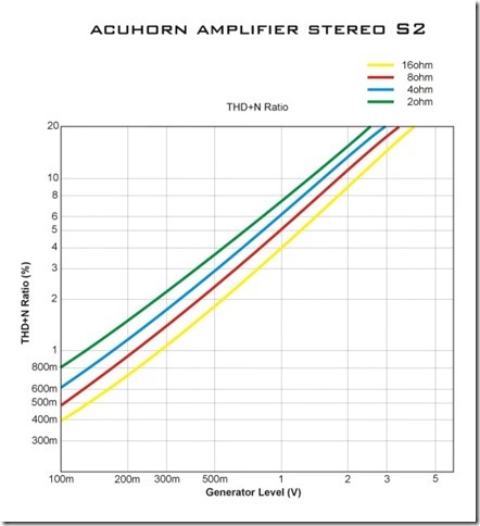

At least one of the graphs above appears erroneous. This would be the frequency response curves, which shows bandwidth based on 2, 4, 8 and 16 ohm loads. Now the output configuration is as I had surmised earlier, a capacitor coupled cathode follower output. The capacitor will interact with the low frequency response more as the load impedance is reduced. So we should see that it rolls off sooner into lower impedance loads but the chart doesn't reflect that- it shows that the low frequency bandwidth is rolling off sooner into higher impedances. This leads me to suspect that the charts are not entirely accurate.
If it's a big cap the LF impedance may be pretty small w.r.t. the load, especially since the follower is probably not very low impedance itself. Still, more likely the follower interacting with the load (including the series cap) -- it would take a pretty big cap to be a low impedance at 10 Hz (1000 uF @ 10 Hz is about 16 ohms) and the graphs seem to reflect an output impedance less than half that...

What about Power Output? One Watt in 8 Ohms?
Reinhard
A little hard to say from the data provided. It shows about 3 V just before the knee in the output sweep, so if that is RMS it would be just a little over 1 W into 8 ohms. And a little over 10% THD...
All that power and commensurate THD for about $5.000...:rolleyes:

I had been anticipating some new circuit topology, although hard to believe we've yet to see anything that hasn't been done with tubes such as the 6C33C. So far the graphs don't support the claims.

1 watt at 8 ohm with 10 THD is not to me an interesting proposition. They will sell a few and fall by the wayside all that IMHO, YMMV. I sincerely was expecting a breakthrough .. Let's be honest and frank and admit this is not the case.
