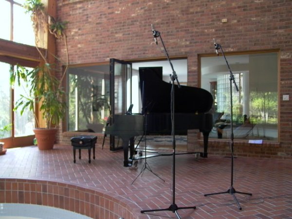

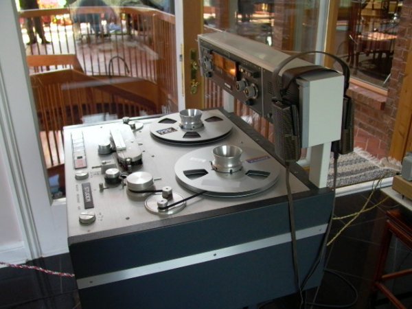

Hi Eugen
I started a thread in diy audio.com talking if you have no more rooms to up grade your system, than try to create your own master tape for supper sound quality with a Studer A80, but end up with arguing in digital or analog recording, in my experience, recorder is just one of the main issue, mic and mic pre amp also another, mic cable interconnect cable even power cord will provide different quality sound. one more most thing is the room, too much to learn. here some pictures show the system in use, Royer tube mic, home made tube pre amp silver mic cable, silver interconnect cable all home made

Hello Tony,
Can you post a .wav file would like to hear your setup, very impressive.The 300B dual mono? mic pre must be very liquid and warm as the 300B is my favorite.
The piano in that expansive space ....wow.

Hi Roger
Sorry my computer knowledge is very poor, I don't know how to post a wav file, the pool side for recording are not my house, my partner's home. and the pool full of water or without water will have different recording sound quality .300B use in pre amp has a lot of noise even WE 300B (because of direct heating ), not every tube is quiet , we had tried and pick up from more than 10 pcs, I am working on a Studer A80's record amp, modify two stages to tube, when it done ,will start make copies (we have two A80) listen to the copy will much better than from computer, be patient

Wait - let me get this right...you're recording this fine acoustic instrument in this space with your A80? Awesome! I began my quest comtemplating something similar, until it became abundantly apparent that an A820 is not a field recorder - LOL. I've revised my estimate with a Nagra in tow...I think it will be great fun, but I'm prepared for some sonic disappointment, too.
Tony - any relation to Winston?
Hi Sam
I don't know Winston is he in Toronto ?
I don't know about A820 well , I only taugch A77 PR99 A80 A810, all I know A820 is better than A810 but simular too many ICs, still A80 is the better one amount those I suppose. no one can tell what will be untill it tried, too many things can effect the sound quality,but there is fun in trying
