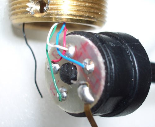

Ground wire from phono pre to the Rega. Do your best to get bare ground wire to touch the arm base. I could slip it under a gap in the arm base for the P9.
Similar to Dan. When I had a Rega table I attached a ground cable to the bottom of the bearing and that solved the hum problem. I used tape to snuggly hold it. Wasn’t pretty but worked.

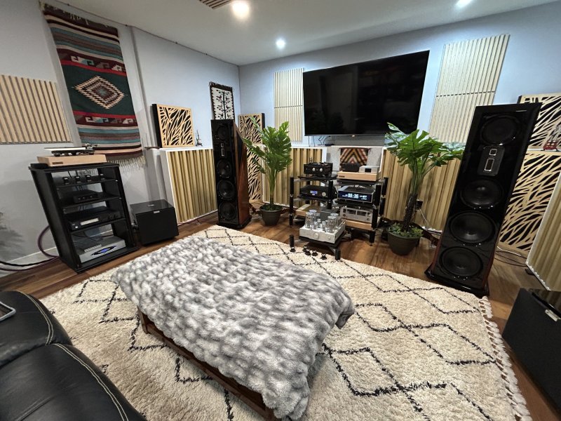

My phonostage and TT has moved much closer to my rack in order to help find a solution for the hum affording me shorter interconnects. That didn't help really. I could move the PS further away however.
