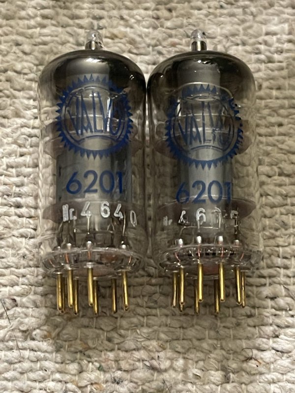

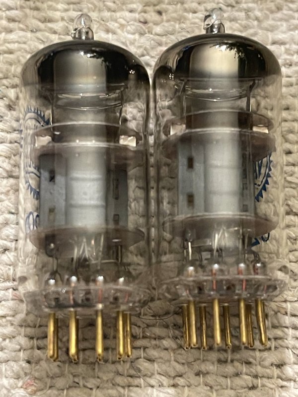

Update I found my favorite tube to date in the lavante " Valvo 6201 D-getter Pinched Waist " rare not cheap but excellent
