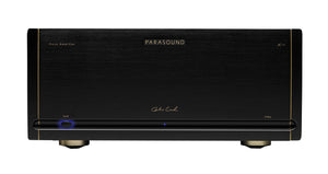

Can handle every load like nothing, sounds extremly good one my favorites.
Thanks for the suggestion! I recall reading a review that suggested they offer a lot of bang for the buck. I also recall reading that if an amp doubles as the impedance halves that it can offer reserves to power lower efficiency speakers. I see that the JC1+ doesn't quite do that, but at the same time, it seems to offer such high power that perhaps that doesn't matter?
you probably need two mains 20A power connections with 120 volts to see what the mono amps can do. power is there in excess. If you want ultimate stability, only something like this will help.67347c.jpg
In reading various power amplifier measurements, I have noticed that quite a few amp manufacturers who rate their 4 ohm power spec at 2x their 8 ohms power spec, have actually underrated their 8 ohm power delivery in order to achieve the appearance of doubling power into 4 ohms.
