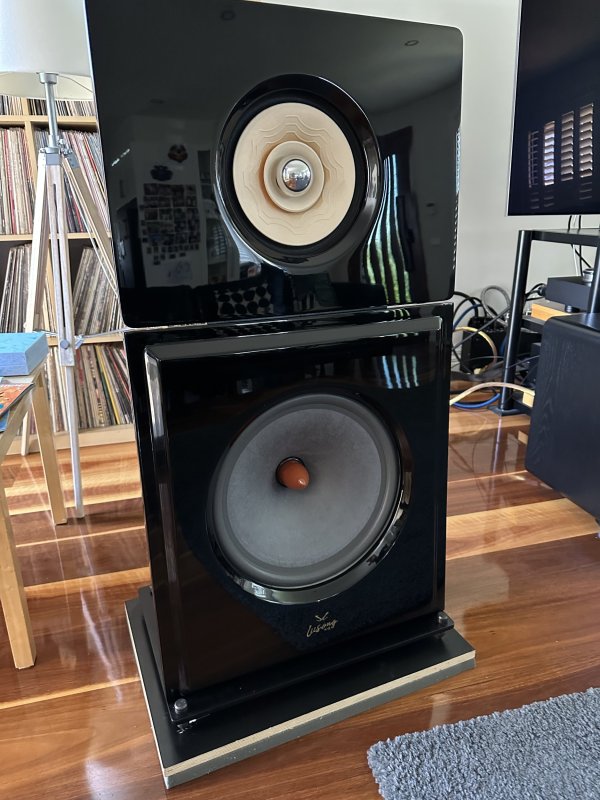

Ayon Spark V driving the Platinum 10 full range driver in my Lii Song Liionidas Extreme open baffle speakers. (the W15 woofers are being driven by Yamaha PX5's).
