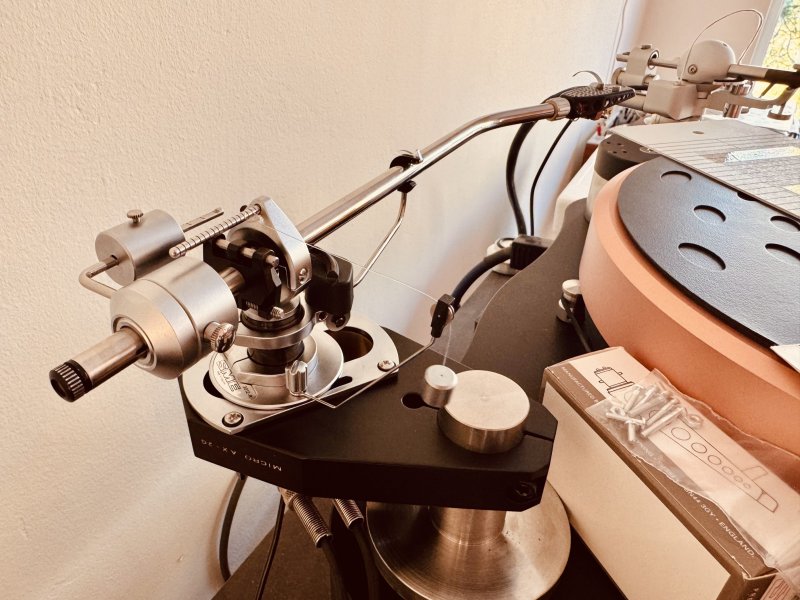

looks like a Micro Seiki AX-2G tonearmboard. These were meant for SME 3009/3010 tonearms.
The correct board for a SME 3012R is the Micro Seiki AX-4G.

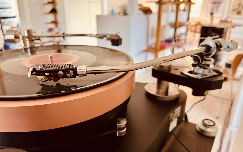

Hi Tony,
That is correctly observed! It is an AX-2G and the reason for it being used on a 12” arm, in this case, is that the arm towers on my Raven are positioned so far out from the platter that AX-4G would make it impossible for me to get the correct mounting distance and alignment. The arm would just end up too far out to be of any use.
I did some thorough measuring before I ordered the AX-2G just to be sure it would correctly fit my 3012-R on my turn table.
And the arm is in place, basic setup and adjusted as a mere start. Now I need to start listening and do all the fine tuning, as well as get to know the arm better.

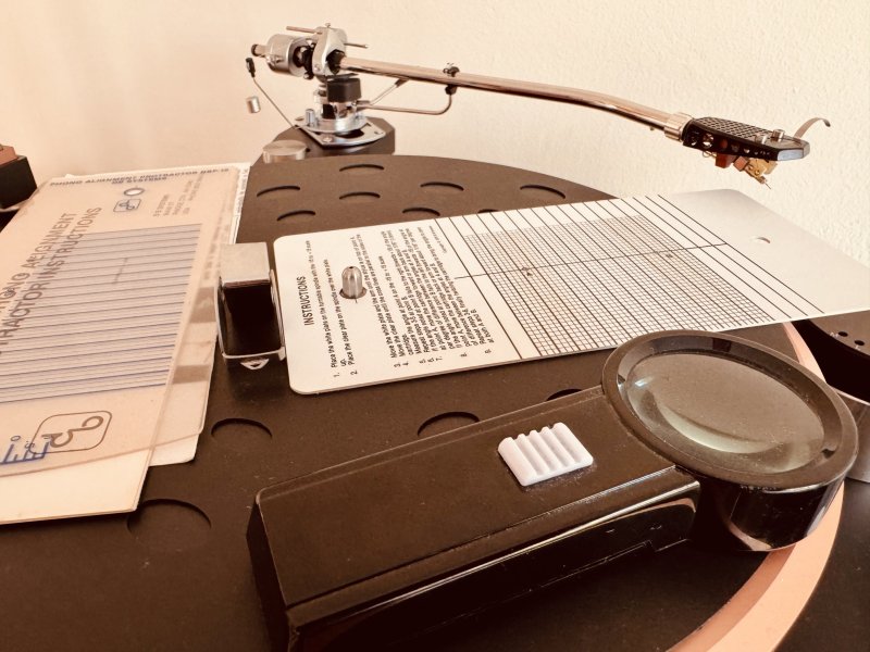

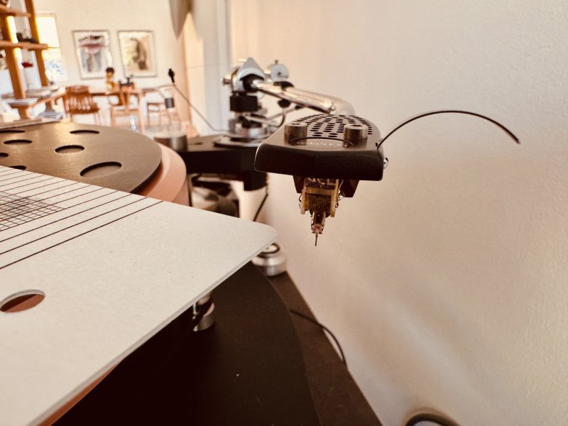

Yes, it is a GCE. This was my first time using the DB Systems protractor but I found using this side helpful with more aiming lines to help me guiding the cantilever to correct position. Do you know if both sides are the same alignment? I do not have the DDK jig but I have read about it in this thread (so yes, I did place the stylus directly on the protractor). Didn’t know it was commercially available?
I appreciate your experiance and tip about antiskate. Will try the lowest setting. (I was really impressed about VTF-setting. Putting the VTF weight slightly below 1,5 grams and that turned out to be 1.35 grams when checking with my digital scale.)
I have had a few different colibris and know that they all are quite different and need proper care when setting up. I will also try the card trick for VTA. Per now the arm, as a start, is parallell to the platter.
Feel free to share more experience with the combination 3012-R/GCE, if any.

Crosswind, I think the protractor is the same on both sides. The advantage of the jig is that you can do the alignment without the risk of damaging the cartridge. Another advantage is that the sides are perfectly perpendicular and it lies flat on the surface of the protractor, so you can get perfect alignment without eyeballing it from above and lining up the sides of the headshell. David had a bunch of these made up but he may not have any more. I do not know if it is available elsewhere. Of course, the stylus directly in the spot is arguably also very accurate. With the Colibris, it is easy to see. Not so easy with some other cartridges.
It is not worth generalizing about the arm height or if it is level. I suppose it is a good place to start as a reference point. From there, use the cards and go up and down to see which direction sounds best. Then continue fine tuning. Do it all by ear for best results. Good lighting and patience.

Yes I like it. A lot to be honest. Too early to say anything of substance, but I start to understand what all the excitement is about. There is clearly a synergy between 3012-R and top of the line VdH that is special.
When it comes to the gun metal base, I can’t give you any feedback on the matter since I’ve only used this arm in this base. Nothing to compare it to. The arm is new to me and so is the turntable. But I do know that, in general, my experience is that other arms I tried in different bases do improve in gun metal bases. Especially the FR64s, seen in the background, improved in the bass. Even more so with the B60 and heavy nut.
