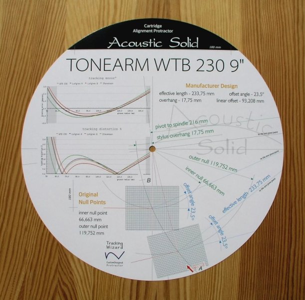

Anyone knowing about tonearm geometries knows that a generic DB Systems Protrac Cartridge Alignment Protractor should not be used for a fixed angle SME tonearm to carry an accurate optimal alignment. The only parameter you are allowed to change in the SME is the distance between the arm pivot and platter spindle. If you want an accurate optimal protactor we can have it designed for us, but we must choose a type of alignment, please see the picture.
Other people have explained you the compromises of your alignment system, I have little to add.
May be we are missing something, but IMO you systematic behavior to ignore or hide details and just show generic aspects does not allow a proper discussion. a1.jpg
