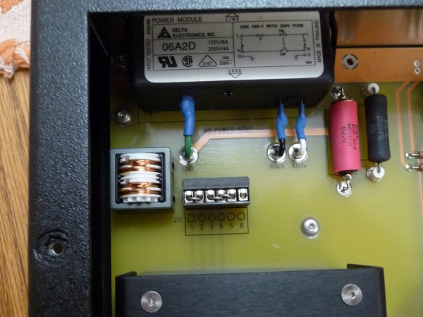

Hi Elberoth and all,
thank you for pointing out regarding voltage conversion.
I bought 15SS 110V recently and need to change it on 220V.
Could anyone help with appropriate photo of jumper set J11 for 230V?
Please see the photo 15ss for 110V
http://imgur.com/GlzYUev
Here is how the jumpers were set in the SS15 I had at home (original european 240V version):
Hope this helps.

No but I have images of the SS30 internals. As you can see, input voltage is beeing switched by this red jumper wire. Just ask someone who owns SS30 in the US to check what is the 115V US setting. On 220V models, it connects pins 1 and 3.
I have just noted that I gave the wrong piece of info in my previous post. The jumper on the 220V SS30 connects pins 1 and 4, not 1 and 3 as I stated in my post.
Here is a different angle which better shows that:
I had also another SS30, this time mk 2, which was set to 240V, where the jumper connects pins 1 and 5:
So it seems the correct pin settings are:
120V: pin 1 and 3
220V: pin 1 and 4
240V: pin 1 and 5
Pin 1 and 2 may be for 100V, but someone from Japan would need to confirm this.
USE AT YOUR OWN RISK !!!
