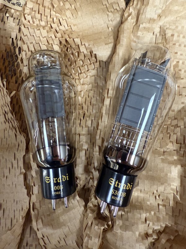

hi everyone! just signed onto WBF to cross post this....thought folks maybe interested in my initial impressions. As way of quick background, I am a 1-3watt SE DHT, 100db+ open baffel guy. My amp is a custom dual rectified, direct coupled (no caps) 417a drive 71a amp with japanese finemet output transformers. I am quiet familiar with 71a, 45, 46, 2A3 and 300B. My fav/bias are for the 71a and 45 then 2A3 finally much later 300B. Less keen on PP, KT88, 66/150, EL34, 211, 845 etc.... of the pentodes my fav is probably EL84.
I'm came home with a pair of S300b (the Valvo Ed) and 45 which I am running in. I have done some brief comparisons with 45 globes incl RCAs and also WE300b 1988 and WE 2022 reissue and I am more than impressed. I'll do a followup once I've had more time. I will also get my hands on some Elrog and Takasuki shortly and some 1960s WE. I am also very familiar with EML, Psvane ACME as well as LinLai Elite. Best!
I recently met Jay Jung (StradiTube's co-founder and chief designer) in Seoul and got to listen to their AD1 (European 2A3), 300B (STC4300/EU 300b), S300B (Valvo Ed in a 300b drop in) and their hotly anticipated 45 and here's my impression...(caveat it was on multi-tap test amp, an unfamiliar system etc.)
534998191_10163935047046177_1693538491837614058_n.jpg.6ecaf73687053c0bbb50428156d53f22.jpg
533726036_10163935047456177_7507141329221194567_n.jpg.ac9605a0dd103f22cbc2ea608396eace.jpg
536110538_10163935047441177_353122291037997353_n.jpg.15aa0be241f531fb2f0a2c81b602869e.jpg
What is their house sound?
  • Linear and extended - this striked me immediately, you get a much more even and extended top to bottom than other brands. E.g. their 300b/45 mid band emphasis is less than other/vintage 300b/45.
  • Low noise floor - StradiTube talks about their low microphics ladder type frame grid which means you hear a lot more nuance of the performance (instead of micrphonics of the tube itself). These are subtle micro details, not etched hyper/leading edge details (which i sometimes associate with chinese tubes).
  • Harmonically and tonally it is more correct/neutral vs overly rich - this is different to more classic 300b or 45 which is on the coloured side. It's not sterile (thank god). Folks may need to give it a chance to get used to what this has to offer. I personally really liked it then again I'm a fan of the 71a tube - which I find more correct tonally and yet very satisfying.
