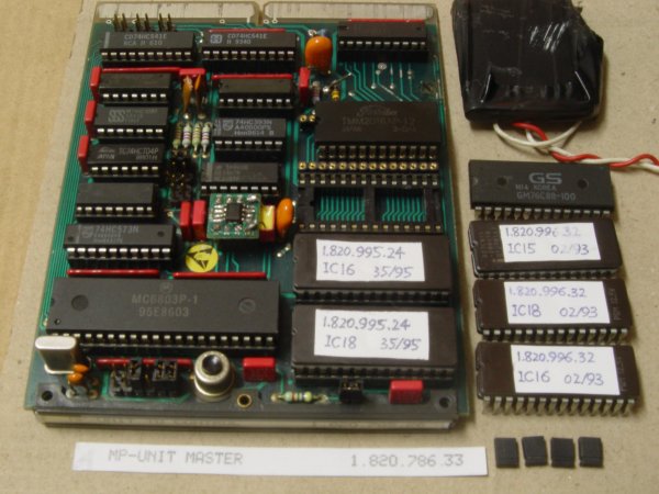

Hello STUDER experts:

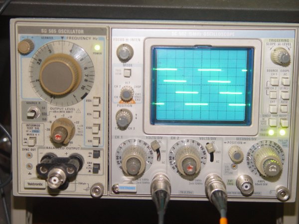

Recently my STUDER A820 developed a problem which prevented it from FF/rewinding/library winding; soon after the command was issued an error message INCORRECT RADIUS MEASUREMENT appeared briefly; then tape tension dropped, tape unloaded. According to the manual the culprit would be tacho sensors (Spooling motor?). Although I do not have an extender board 1.820.799.00, I managed to soldered wires from six resistors after pin 1~4, 7,8 on TD Couter/timer board 1.820.761.82, which represents two 90 degrees out ot phase-50% duty cycle square wave from left/right tacho sensors of left/right spooling motors and the motion sensor. The duty cycle of each of six square wave signal was measured/adjusted by monitoring it through a scope.
Problem persists.
Other aspests of the tape handling of this A820 seemed to be O.K.
Currently configuration:
SM-DRV: 820.759.84
CAP-CTR: 820.764.28
CAP-IF: 820.727.00
TD-PER: 820.762.81
TD-C/T: 820.761.82
SM-CTR: 820.760.82
TD-MPU: 820.785.26
TD-S IF: 820.763.83
M-S IF: 820.753.82
M-MPU: 820.786.33
M-PER: 820.728.81
Firmware: Master MPU: 1.820.996.32: 02/93; TD-MPU: 1.820.995.24; 35/95; Capstan Control: 1.820.994.27; 10/92
After firmware update this A820 operated half a year without any problem.
Any suggestion?
I reviewed the tape tension sensor offset and gain control again and found that the right tension sensor offset and gain was off a little bit; an easy correction of 5 minutes' job. Now everything was back to normal!
Each time machine got trouble it was time to learn something new. I had learned how to measured TD-TML1/2, TD-TMR1/2, TD-MOVE1/2 and made adjustment for optimum 50% duty cycle square wave.
