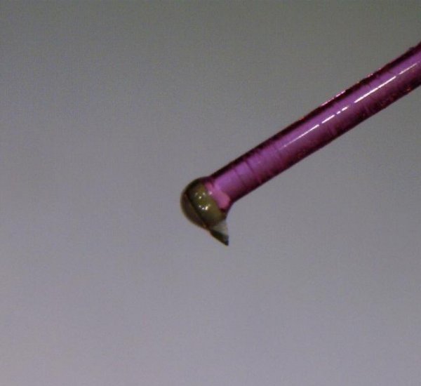

Here's what a dirty stylus looks like.
After cleaning, the stylus still looks like it's nice and sharp.

Looks like a Sound Smith rebuild.
