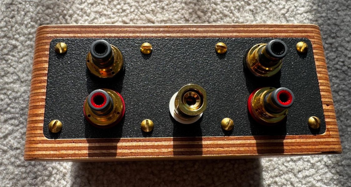

Interesting comment. I made a comparison between Kondo SFz and Misho WoodenSUT (with the DaVa Reference cartridge) two times, and had a very similar if not the same feeling. Yes, Kondo was a bit more open on top and had somewhat stronger bass, a bit more detail overall but compared to the WoodenSUT, I always had a stronger feeling of reproduction, WoodenSUT sounded more like live music.
What was the cartridge used for this test?
As I wrote in my report, DaVa Reference.
