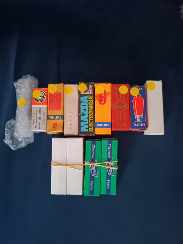

For the preamp part I tried NOS Mullard, Tungsram, Brimar, Radio Technique and RCA.
Here again RCA smokes them all by a wide margin paired with the KT120s.
