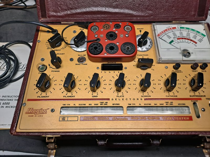

Hickok 6000A

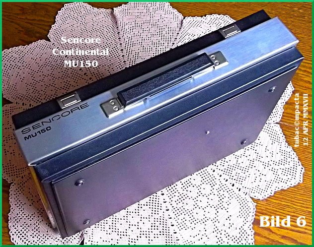

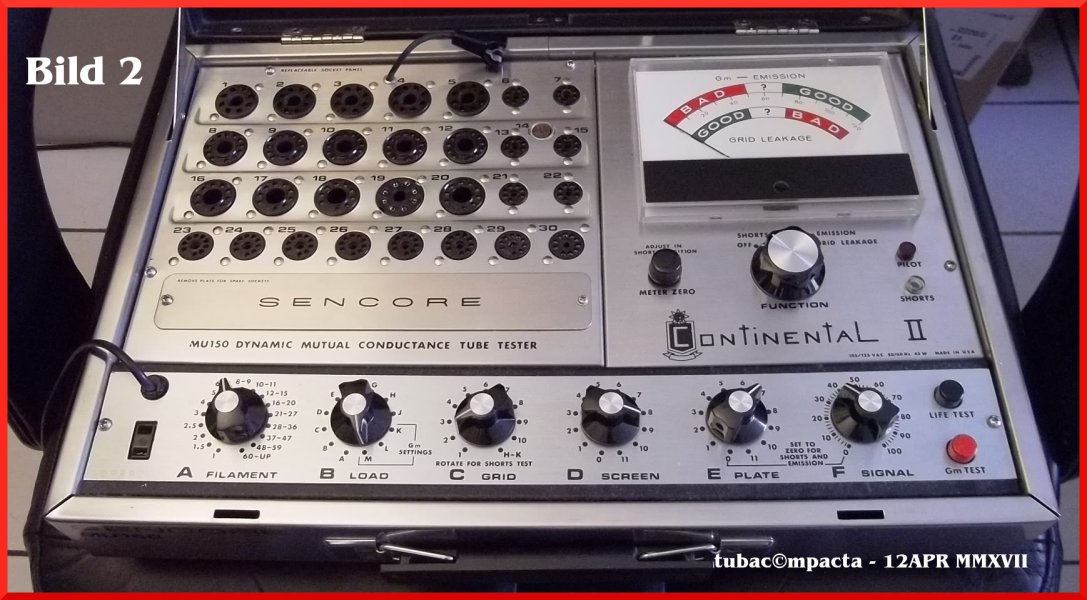

I purchased the tube tester shown in the picture on eBay from the USA in early 2000, and I modified the internal power supply from a 115 VAC connection (105 - 130 V, 50 - 60 Hz) to the German mains (230 V / 50 Hz).
A detailed discussion about the Sencore MU150 Continental II can be found on my website. On the left-hand column of the homepage, there is a Google language translator for translating from German to English.
https://www.tubacompacta.de/elektronenröhren/röhrenprüfgeräte/sencore-mu150/
You can also see other tube testers by Sencore, which I also purchased from the USA and thoroughly checked.
https://www.tubacompacta.de/elektronenröhren/röhrenprüfgeräte/tube-tester-usa/
A German tube tester, the Funke W18, which I have fully refurbished, is shown here:
https://www.tubacompacta.de/elektronenröhren/röhrenprüfgeräte/funke-w18/
Enjoy studying the information, and best regards from Germany.
Kurt

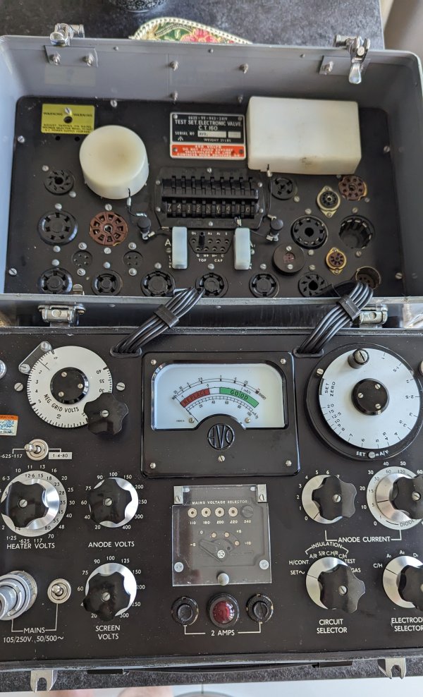

I have an old AVO CT160, ex-Army, REME. It's a lovely piece of kit, great feel to use, big chunky switches.
I did service it about 12 months ago, re-calibrated it. Again I use it mainly for go/no go valve testing, particularly on valves that came installed in equipment I've bought.
